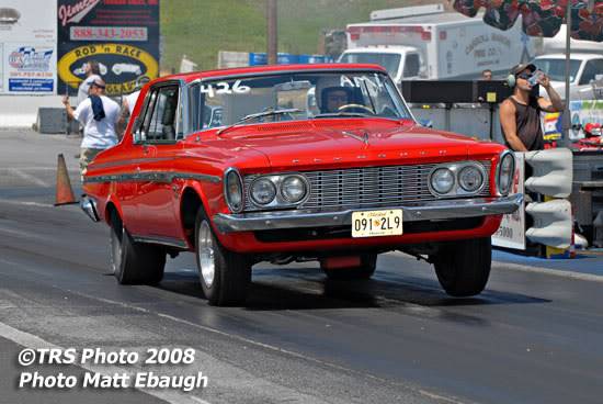

I decided to get SS springs and put them on my 63 before I go to the track on Nov the 8th. Now I can get a nice stance without air shocks. And on my launch you can see the R/R squats more then it should with the weak original springs. Now I can't wait to get them on and try them at the track. :) Ron

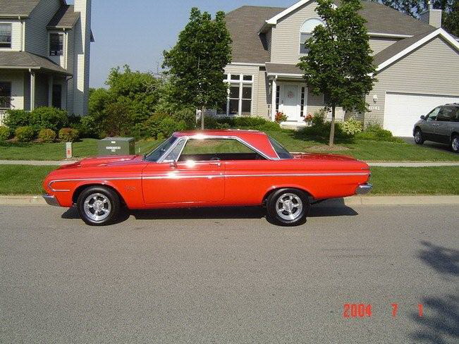

Here's the stance of my '64 Belvedere with the 6 leaf springs with 2" of additional arch.

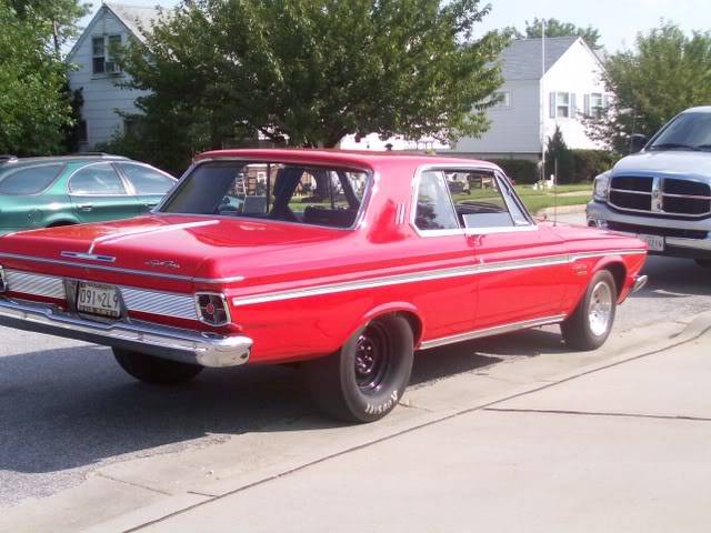

I knew the A-body springs will bolt right in. But my car goes 3700 with me so I bought the Mancini 3400 lb SS springs. They came with new U-bolts , rear hangers and bushings all for $219. I did not get any pics yet but it sits about the same as before when I had air in the air shocks which is like this. But now I dont need air shocks. :)
I went to the track last Sunday but it was a windy and damp day. It did drizzle a little but they did race. It was only about 50 out and the sun was not out much and it was very windy. So they made us run the 1/8 mile. :sad: I hate the 1/8 mile but it was better then no racing. I ran 7.36 @ 93.84 mph with a 1.62 sixty ft. My best ever on my 11.52 pas was a 7.33 @ 93.88 mph in the 1/8 so I figure that 7.36 was about an 11.58 pass. The 1.62 sixty is about normal for my car but it launched nice and straight which it did not do before with the old worn out springs. So I am happy with the launch and hope to work on getting a bit faster next year in some good air. Ron

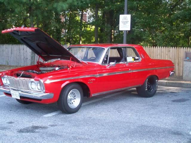

It sits just like in these 2 pics. Oh and it was also nice to stop on my way to the track and fill up with 93 pump. And when most all the guys I raced against were loading their cars on the trailers I just drove out of the track and then drove the 45 miles home. :) Ron
