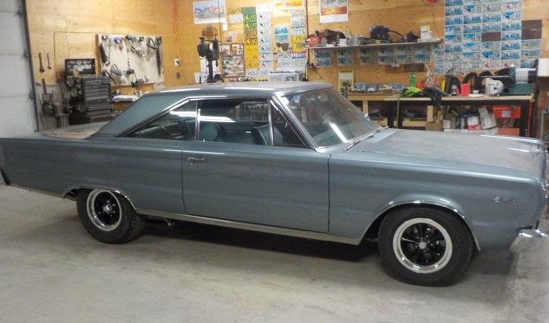

I got so " wordy " I forgot to post pic .. or then again maybe it has to do with being over 60 .
Coil over K-frame or torsion bar K-frame?
Coil over k frame front conversion...and the rear is what I'm on the fence about. Conversion to coilover...or going with new leaf springs and some new/high quality shocks.
