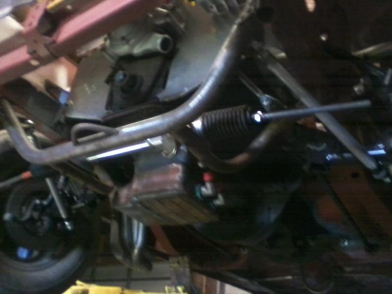

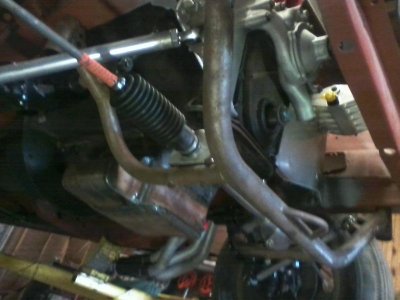

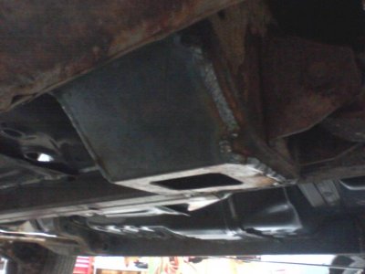

Here is my own set up I made. It's not painted yet as I am haveing it powder coated after the mock up in finished. It works well so far . Note the torque strut's to the motor mount pad's. Keeps the whole front end tied in as one.km1.jpgkm2.jpg
There is one on both sides but hard to see in the pic the right one.
