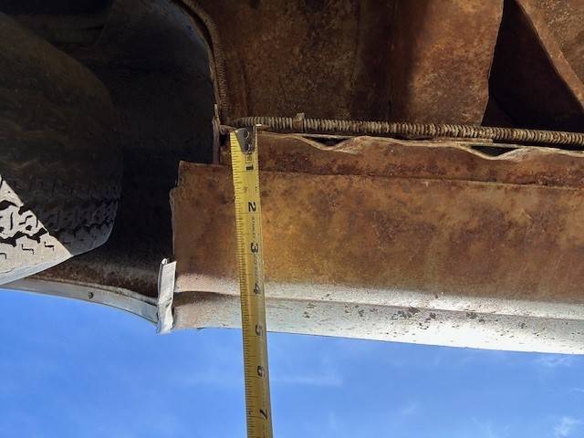

I have been welding in patches on my '63 Polara. I am having one issue. At the front of the rear wheel opening, where the quarter rolls under, I can't tell exactly how far the patch should go. If someone will send or post a picture of an early B front of the wheel opening, from the bottom, I sure would appreciate it.
Thanks in advance, John
Like this? 62 Plymouth for reference.
