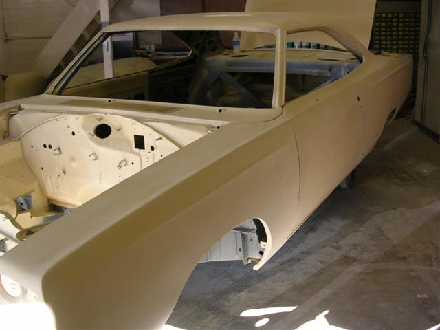

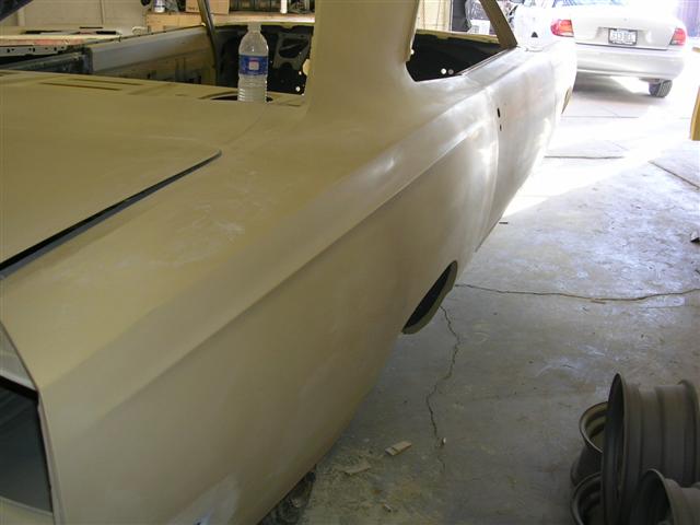

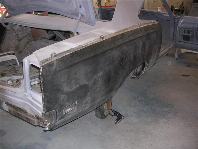

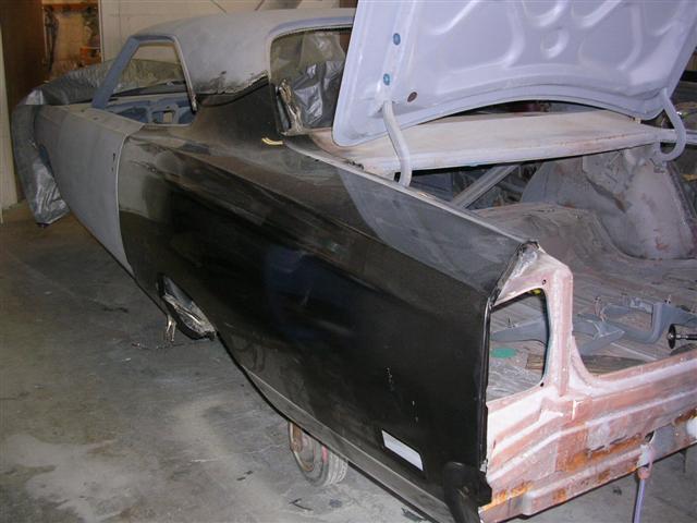

The two rivers are skins as seen in my first pic. The tooling is all worn out bad edges but can be used for patches. The second pic is AMD full quarters, good fit but the reflector pocket is to deep. So we cut the pocket out of the skins and fit them over the top of the AMD parts! AMD came out with the quarters in the middle of my project and I disliked the skins enough to start over!

The reflector holes are to deep on the AMDs ? The last set of skins I did were to big and the reflector didnt sit right. On my Dart they were so bad we cut around the factory reflector holes.
