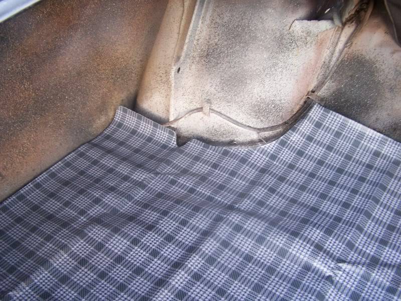

I was wondering hows the trunk suppose to look? as far as paint. Was it black, wrinkled or just over spray from the exterior?

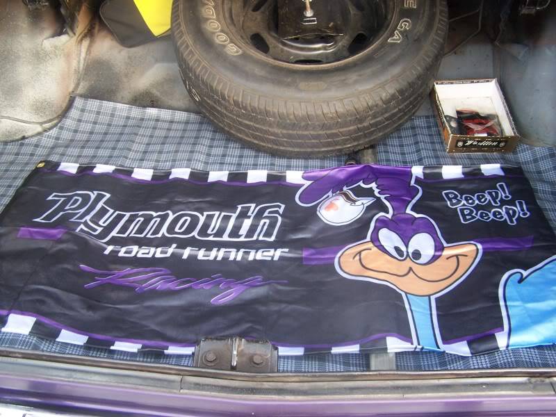

This is how it looks,
I would advise you to remove that rubber mat. That stupid thig holds water underneath ! i just removed the one in my '65, and guess what ? i am now redoing my trunk floor. Thank god just surface rust ! I will be rolling on some grey bedliner. The trunk paint looks good, but expensive and hit/miss with quality.
Thanks, I have noticed water laying on top I was thinking that if I sprayed underneath it wouldn't be a big deal, but you do have a point I'll have to figure something out. Have you or anyone else tried something that has worked? I see some trunks look body color and some are black.
Btw how is the jack suppose to be placed in the trunk? As you can see in the picture i had the spare tightened down on it to keep it from moving but today while i was putting the spare in, i decided to put it in sideways under the tire looks a little neater but i was wondering how it should go.
Yeah man, if you have any moisture getting inside your trunk that mat will hold water under it and rot the floor out quick ! As far a color goes, pretty sure the original color was grey .... not sure on the jack mounting !
Thanks i'll keep an eye out, I never check under the mat. i know i have a plug out but with the mat over it i doubt its helping much. I have noticed water but it usually puddles on top of the mat after i wash the car. While the mat was out i didn't notice any rust, maybe i'll start leaving it flipped up over the spare and just lay it out when i'm at shows.

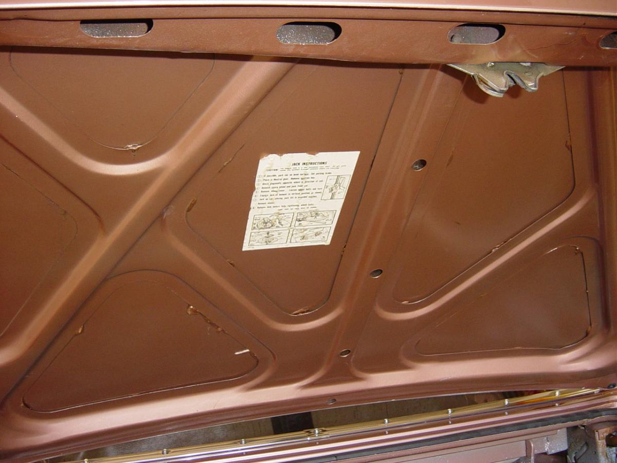

There is a sticker that attaches to the bottom of the trunk lid that will show in some detail how to stow the jack.... also found in the owners manual. If your car has been resprayed it may be gone... They are avaliable for less the $10.00.

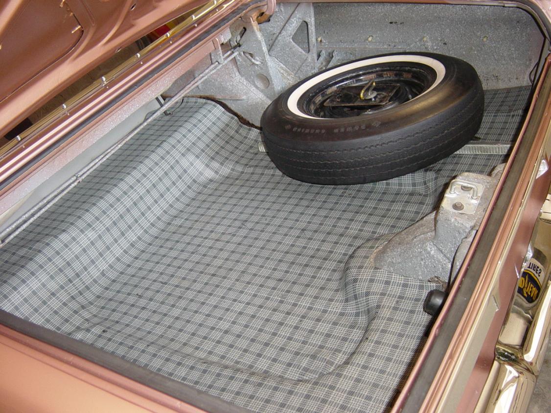

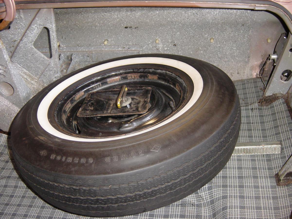

This doesn't answer your question directly but since there was some mention of 65 and earlier trunks and the FBBO server wouldn't load pictures yesterday, this is a photo test and some early documentation. The 65 trunk pictured is an unrestored California Belvedere convertible that still has the Goodyear Power Cushion whitewall spare, the jack packed as original, and the jacking instructions on the trunk lid. There isn't a speck of rust under the liner so it does work in some cases and the splatter paint does go under the liner not body color.

Yeah sorry about that i was too tired to think about mentioning the year. It is a 69' Roadrunner clone. Thanks for the help so body color is correct good to know.
