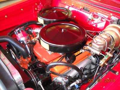

There is NO room for the compressor with the crossram...
Thank you. The bracket was fabricated by a local hot rod shop to mount the Sanden compressor that came with my Vintage Air set-up. Unfortunately, that's about the only way to mount it, low on the driver's side, and keep my mechanical fuel pump.

That setup requires non A/C pulleys and a water pump with the inlet on the driver's side instead of the passenger's side.... so there will probably be some different parts required depending on what you already have, but there should be no fab work necessary. If you're going to spend nearly two grand for a dual quad setup it seems pretty insignificant to spend another couple hundred on the correct pulleys, brackets and water pump housing to keep your A/C.
