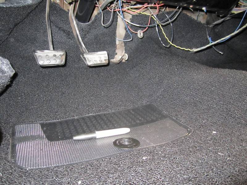

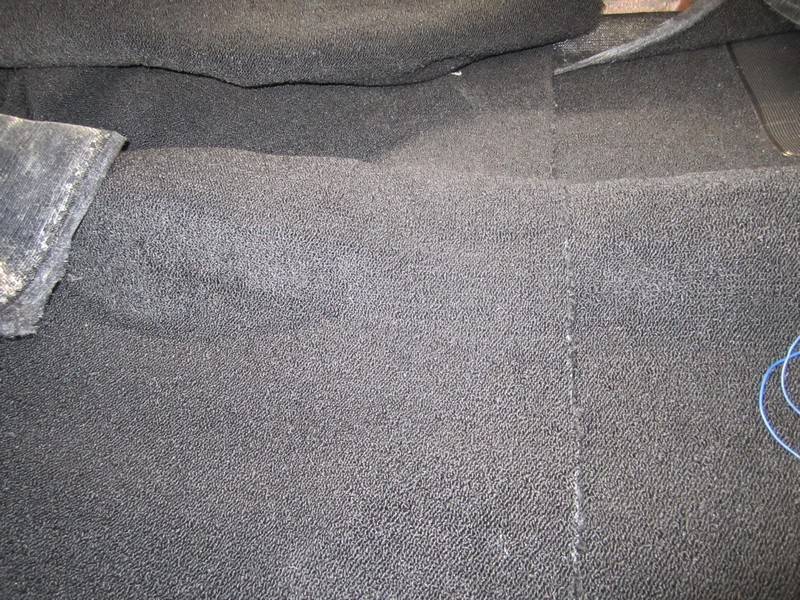

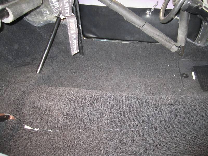

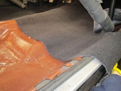

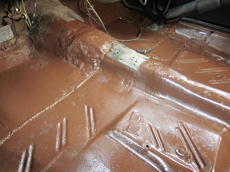

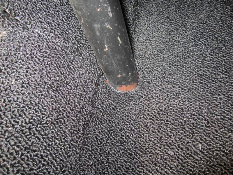

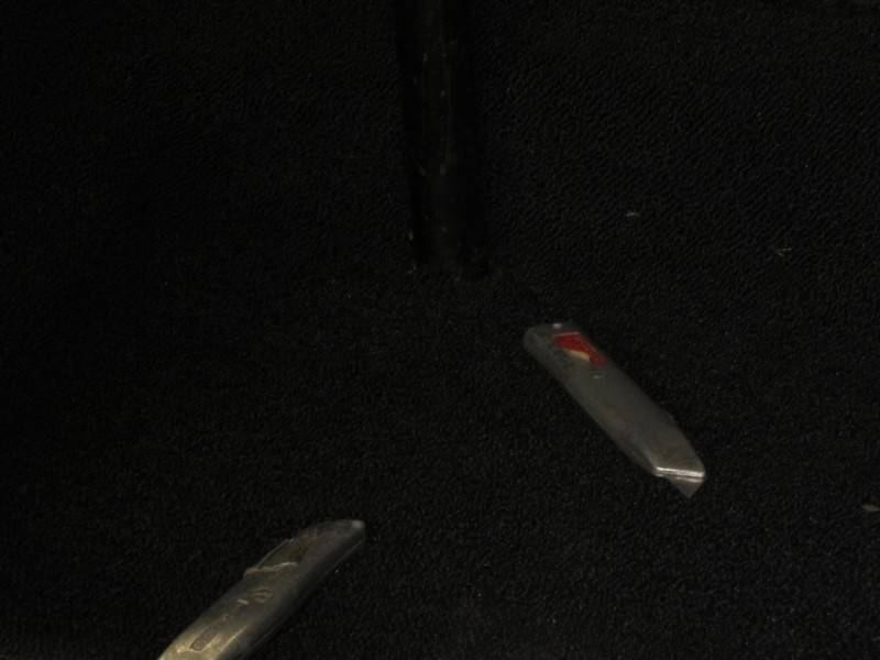

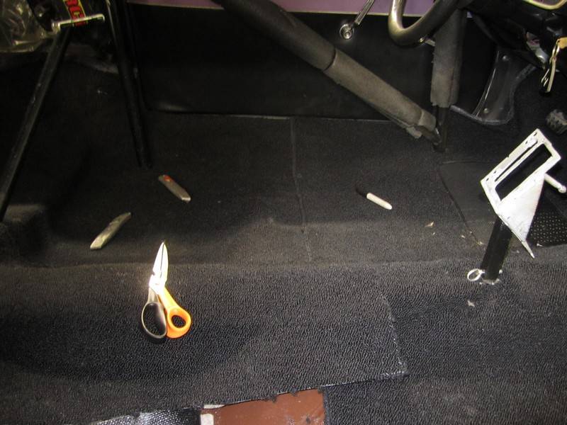

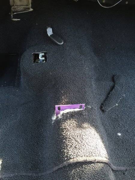

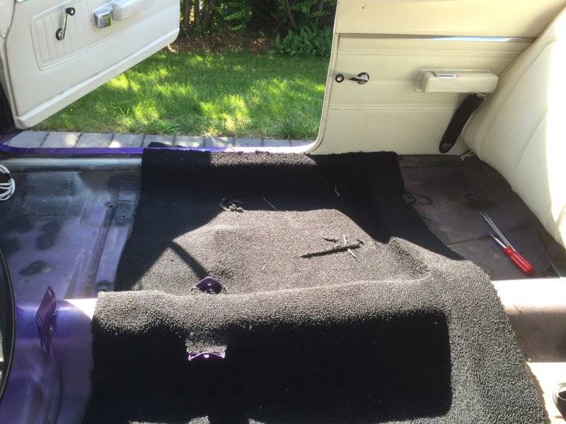

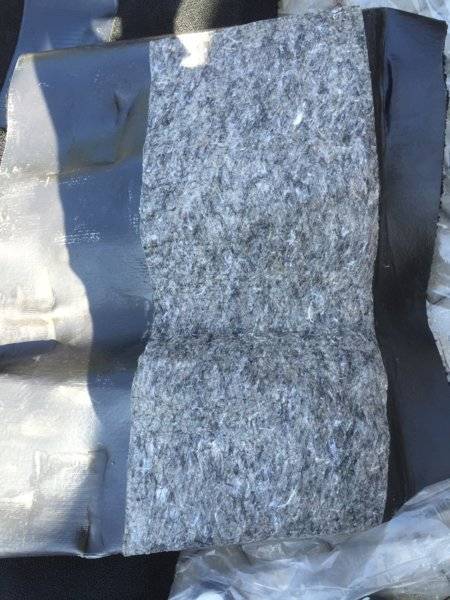

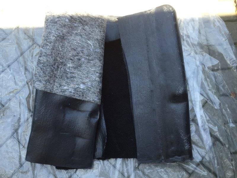

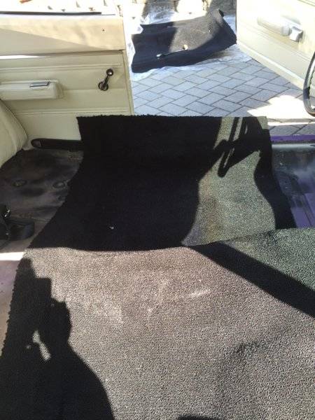

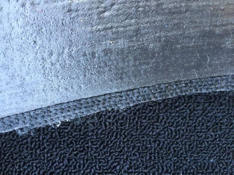

Looks good. Yep, that’s the area by your red screwdriver.I used an ACC carpet with the heavy mass backing, basically rubber glued to the back of the carpet. As others have said, the carpet is formed to the floor pan. I laid mine out in the driveway for a few hours before install. It fit almost perfectly to the floor pan. Once trimmed and the seats/moldings put back in, the carpet didn't move at all and the fit was excellent. No clue used at all. Here's some pics.
View attachment 715069 View attachment 715069 View attachment 715070 View attachment 715071 View attachment 715072 View attachment 715073 View attachment 715074 View attachment 715075 View attachment 715076 View attachment 715077

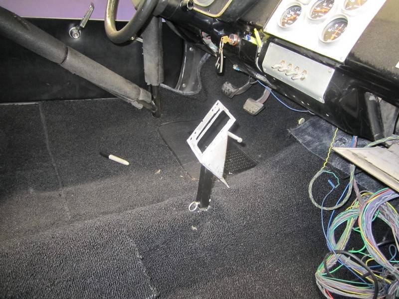

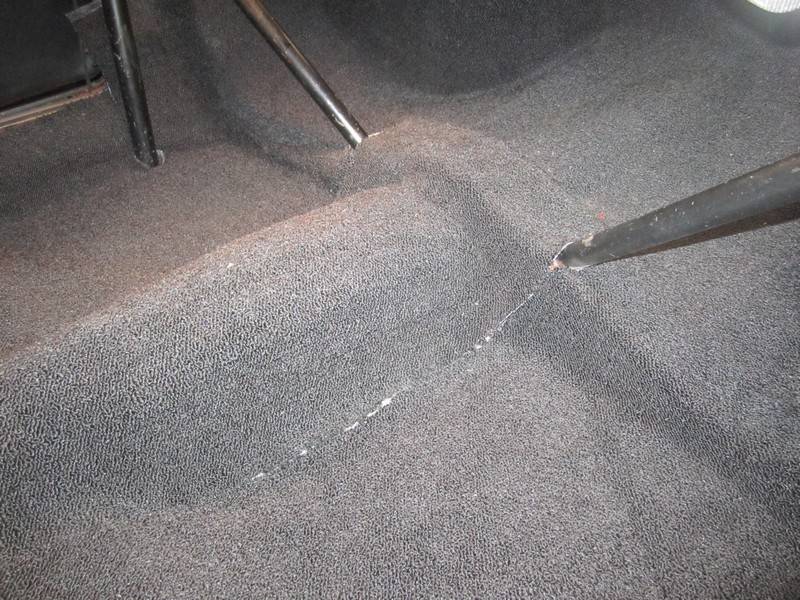

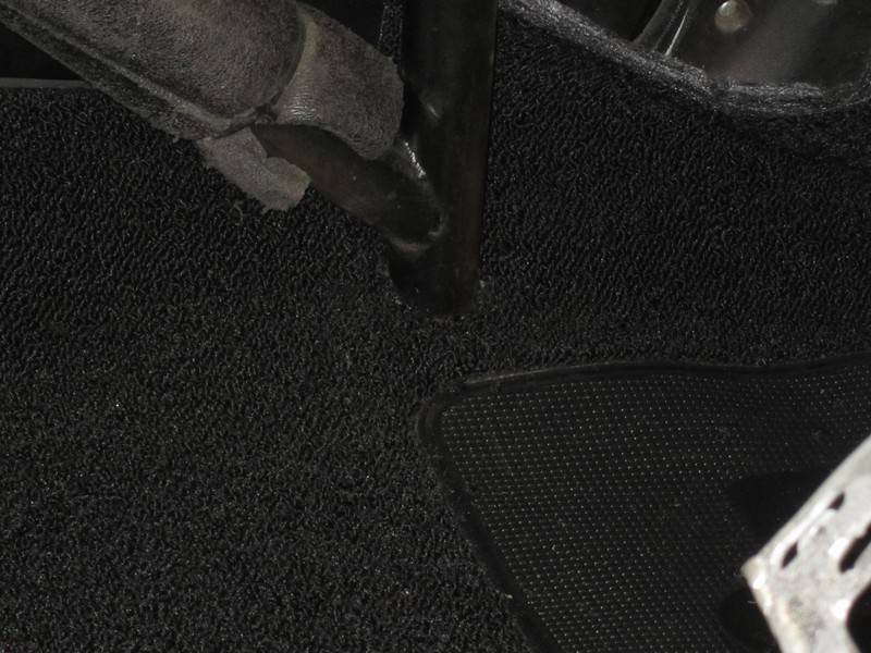

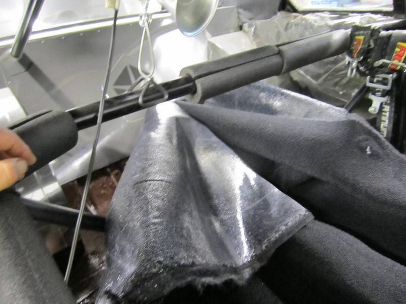

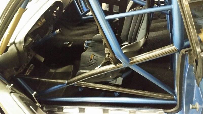

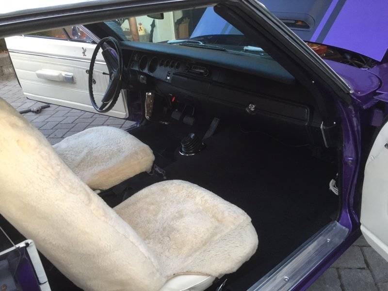

Might as well throw my hat in the ring...

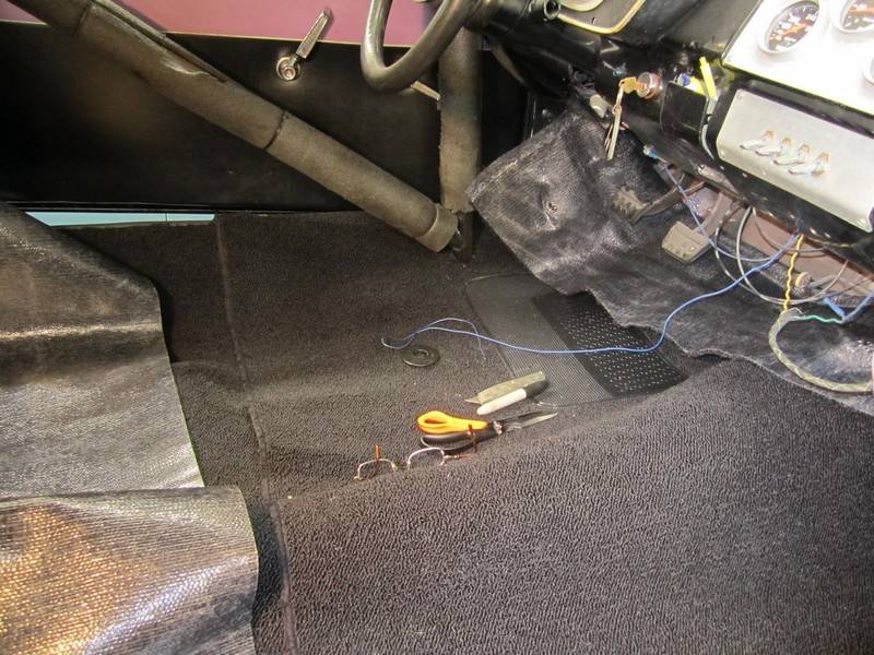

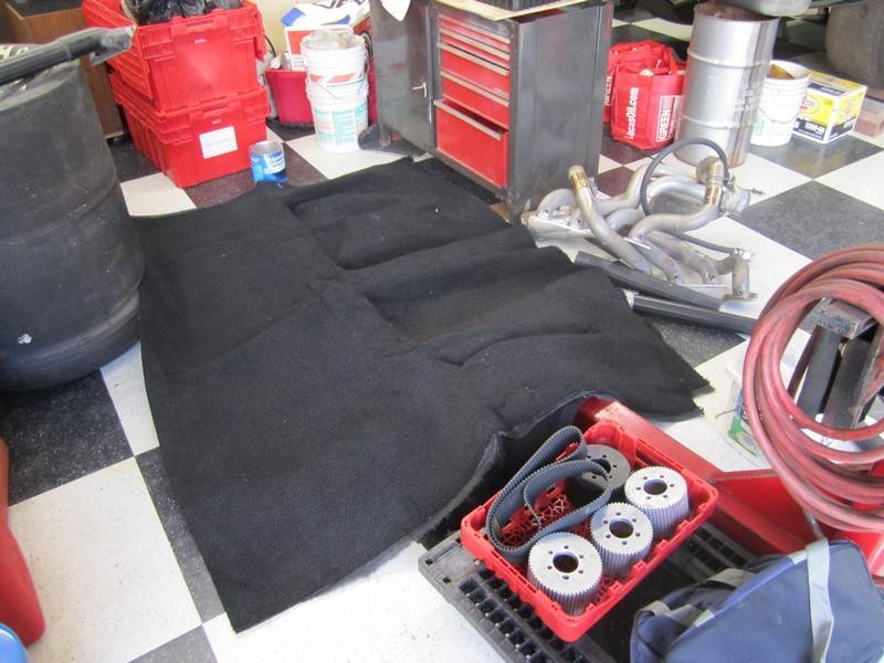

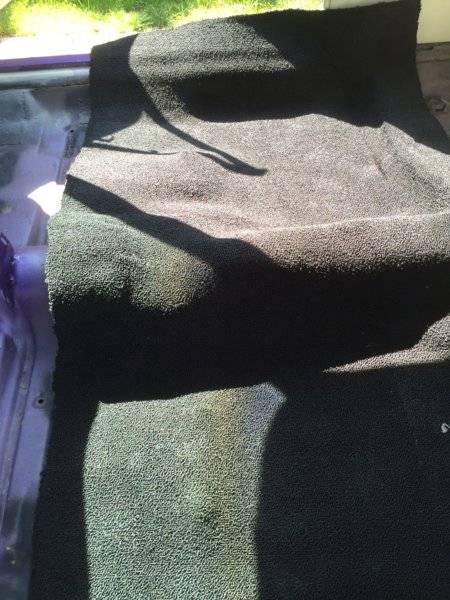

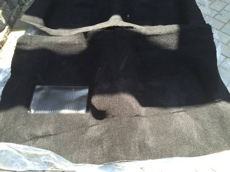

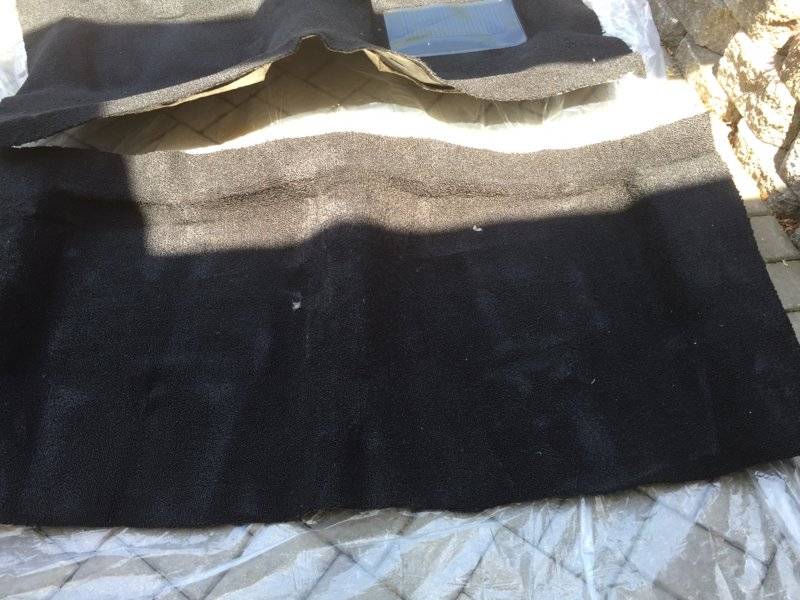

Bought mine from ACC and the date on the box was seven years old. Removing the carpet from the box, it reminded me of a crumpled up piece of aluminum foil. Took lots of time, heat and effort to get it flat enough to use. I didn't have any other alternatives. No glue. It wouldn't do any good because it would probably just tear the sound deadner/insulation apart. Once everything is in place and with installing hardware, seats and trim, it's not going anywhere.

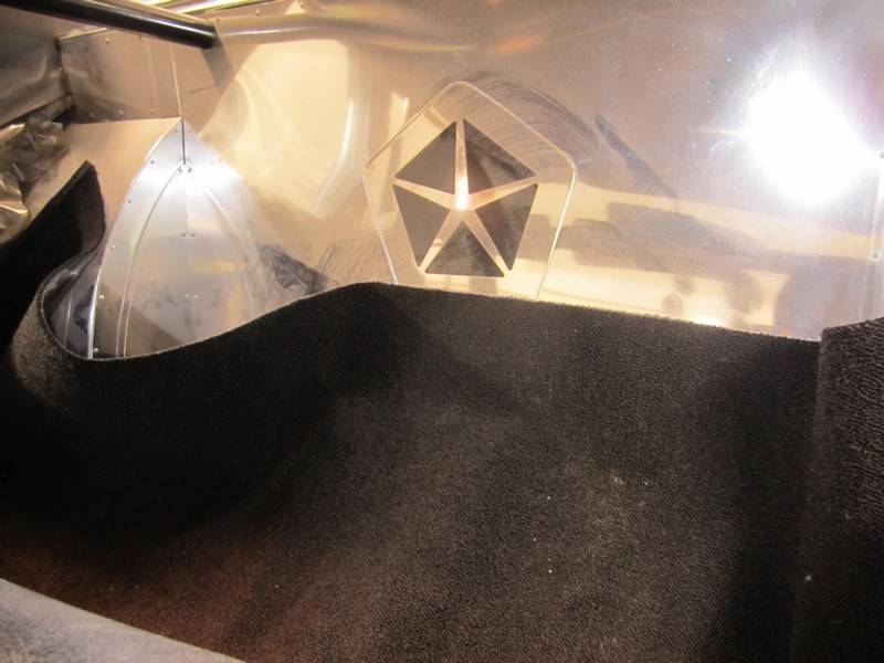

Under the rear seat won't matter much because nobody is going to see it. Just make sure you can match it up perfectly to the floor pan and any other references that will help with locating before doing any cutting. Cut/trim the sill plate edge last.

Im not trying to be critical. So, please excuse me. But the area under the rear seat you do clearly see. There is a vertical wall with round corners that you clearly see right at the front edge of the seat. Not to mention, the hump. Maybe hardtops are different. But, I think on a convertible this is a subject area not using an adhesive of some kind. Im teetering on not using anything. But that area isn’t flat. A lot of contours.
I was referring to what's hidden under the seat. I know what you're saying about the sides and the front.
I'd get it in place and see what it looks like. I used a heat gun, lightly, to warm the backing and laid it back down, sometimes with weight on it until it cools. If it won't cooperate then maybe some spray adhesive could be used.
