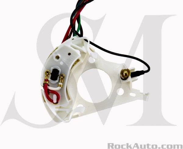

I have the same problem, mine is the right brake light that doesn't work. Has anyone used this turn signal switch they sell at RockAuto?

Interesting, because in order to get the right turn signal to work I need to push it a little past the normal detent. It is the right side brake light that doesn't work, so maybe something is misaligned?
