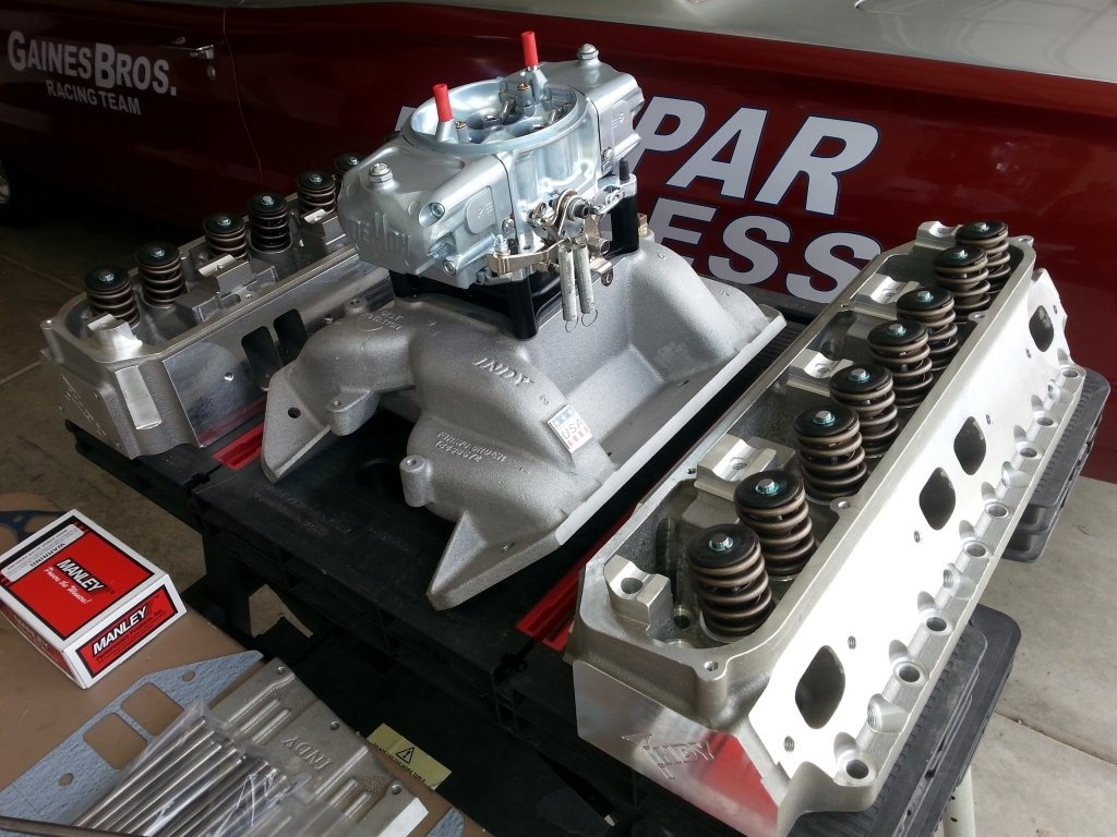

I have no cam card and cannot locate the cam through comp cam without the serial number. So here we go with a lash question. Suggested valve lash???? I was told it should be aroune .026 .027 I am looking for similar builds to try and compare to this motor. Here are the specs on my motor. 511 400 factory block Main girdle ARP main studs Eagle 4.25" stroker crank Eagle Rods Ross Pistons Clearances are .0025-.0030/.0030 Clevite bearings and Total Seal rings
All balanced of course Muscle Motors ext oil pump
Compression ratio is a bit over 12-1 Comp Roller .730/.730 lift 284/288 @ .050
Comp lifters
KB Gear Drive
Indy 440-1 heads with full CNC port flow [email protected]
T&D rockers
Pac Springs, retainers, locks and caps
New 2.25/1.88 Manley Valves
ARP Head studs
Trick Flow pushrods
Fel Pro Head gasket
Indy 440-3 Intake, Dominator flange
thanks Mopar Chris..
I have since replaced that Indy Dual plane Intake and 850 Demon with an Edelbrock Single Plane intake and 1050 Dominator.
