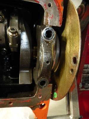

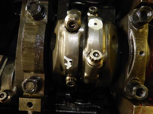

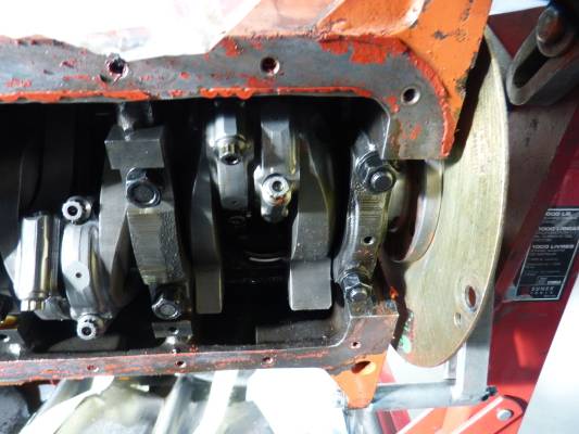

Any suggestion about my main and rod bearing caps ?
I just get this photos from the mopar and engine shop who build the Hemi and was now after 4000 miles inspect rod bearing 7 and 8 , and main bearing 4 and 5 because the engine was out of the car and I give the order for checking the bearings just for Interest.
After the shop inspect my bearings I ask if everything ok with the bearings ?
They answer me yes everything normal not necessary to change the bearings . and they put the checked ones Back to the engine .
After the engine was together again they send me also the pictures of the checking procedure ...
what you think about it, I a Full rookie , but hey is there not some missing piece of bearing on the corner of one rod bearing ???
And how about the other bearings and crankshaft ? It’s normal “ wear” after 4000 miles drive ( no race , no full throttle , just normal cruising drive it up to 4000 miles )

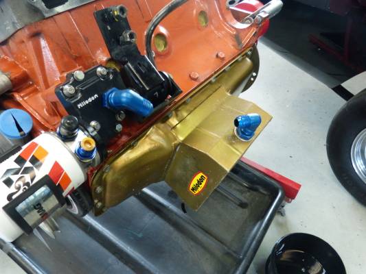

Here some pictures from the oil pan , what you think . The shop tells me also all be ok , no problem with the oil .
That bearing is shot, whatever caused that should be rectified.:BangHead::BangHead::BangHead:
thank you for you’re suggest!
oh my god , this shop who built the engine and check the bearings tells me just be normal wear , not necessary to change it , and put the old bearing on again... damnn .
