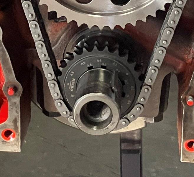

It is hard to tell with the chain in place.

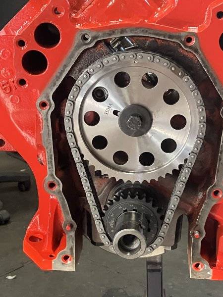

I would guess that a cam retarded one tooth would have a more negative (negativer?) effect than a cam advanced by one tooth.

On the roller type timing chains we use on BBM's there are 25 teeth on the crank sprocket and 50 on the cam sprocket.
It's more than counting teeth. Crank speed is double cam speed. One tooth either way is a bunch. Look at degree bushings and subtle change between zero and four, and then look at a single tooth; that's a bunch!
If you get the cam sprocket off 1 tooth your cam timing will be out 14.4 degrees. And that's way off. This is why a typical gear drive has a 7 position vernier. That way when your cam is off a little you can change it around 2 degrees per hole position. The RCD gear drive has an 11 position vernier.

I realize that you just divide the number of teeth on the sprocket by 360 but which sprocket do you do the math from?
360 divided by the number of teeth on the top sprocket (50) is 7.2. The camshaft turns 1/2 as fast as the crank. So when you check the timing (which you do on the crank) it is twice that much. 14.4 degrees.
Or, to phrase it differently. One complete cycle is 720 degrees since we are working with a 4-cycle engine. Being off by one out of 50 teeth on the camshaft sprocket is 720 degrees/50=14.4 degrees at the crankshaft like @rickseeman already replied @Kern Dog
You can count the teeth just the way it is. The lower sprocket is easier because you only have to count 1/2 as many. The pins in the rollers will help you.
