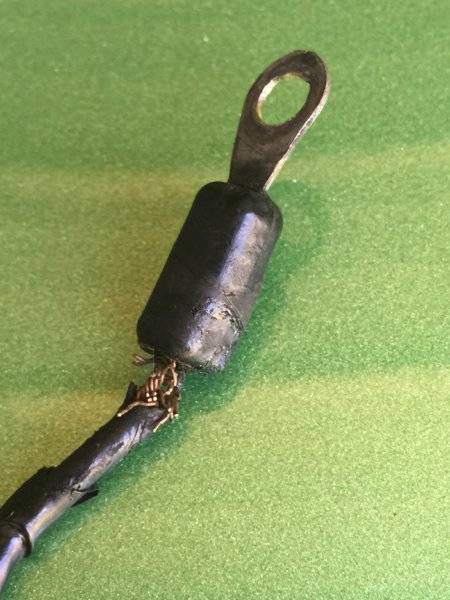

Mine used to run great cold but after long drives when hot is would die at random, especially when put in gear.
Like it had a kill switch...
Turns out someone in the past had taped some wires up in the engine compartment. When the car was cold all continuity/ohms & grounds checked out OK. Evidently when it got hot the wires sagged & lost connection.
It was a bugger to figure out & then OBVIOUS when I peeled off the tape to see what was under it.
This was the primary coil connection:
Snipped it off, put on new, problem solved!
