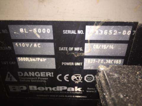

I have an email into BendPak as we speak. My model is a BL-5000 from 2014. I emailed support to see if those extensions will work with my model

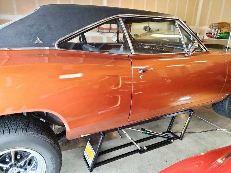

This is mine the other day and I bought the extensions. Works great!!!!! This is also half way up but a perfect height to do the brakes.
Bee1971's post has me looking at this again. But I wonder why extensions are needed. The 5000 SLX extends to 60" lift point and the length between the front and rear lift points on the Coronet is 48". Seems there's plenty of wiggle room to work with.

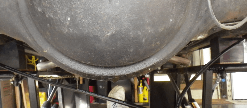

Has anyone run them across the car rather than front to back? I see one problem the driveshaft/ rear differential drop.
They're not designed to run across the car. And I don't know if you could with the tranny and exhaust system in the way.

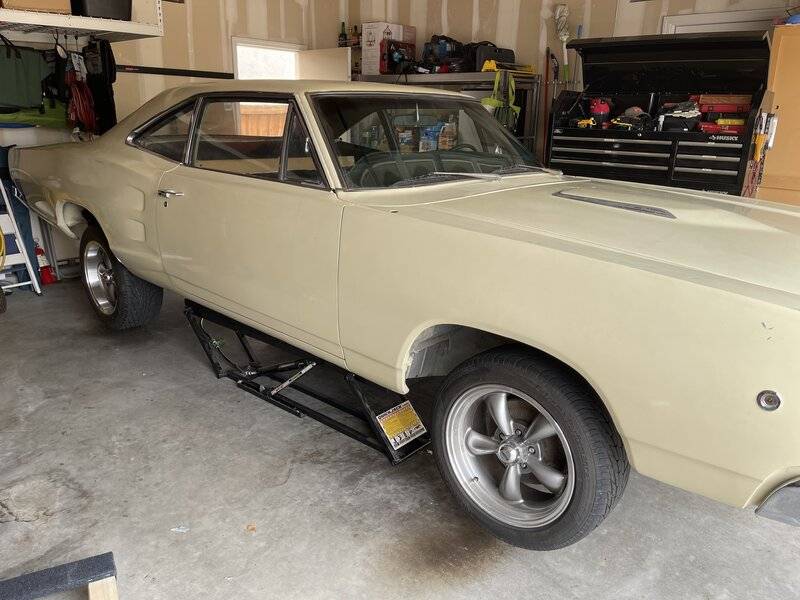

For those who don't have a QJ, the photo is misleading. In the photo it looks like the support rails end half-way across the doors, but they extend past the doors up to the perpendicular frame rails right behind the front tires. The back of the rail lifts at the rear of the torque boxes, just in front of the spring perches.

.....I see one problem the driveshaft/ rear differential drop

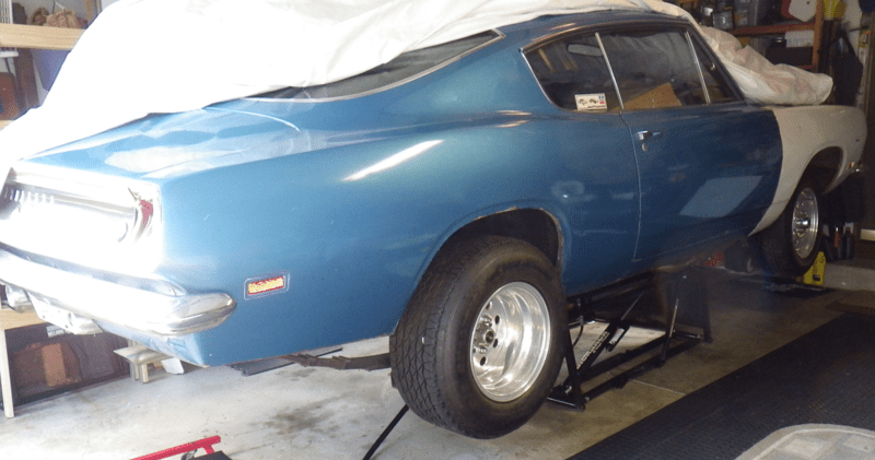

From an old picture when I first got my QJ it looks like with the blocks stacked there is plenty of room with my Barracuda.

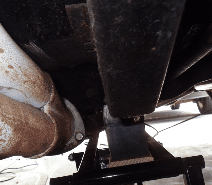

So wait, you put them cross wise on yer Barracuda?
I haven't tried it yet but I believe I can do it without issue. The stacked blocks should provide enough clearance for low hanging items.
My blocks are stacked on top of a 2X to clear the FW and the exhaust turn ins..........
