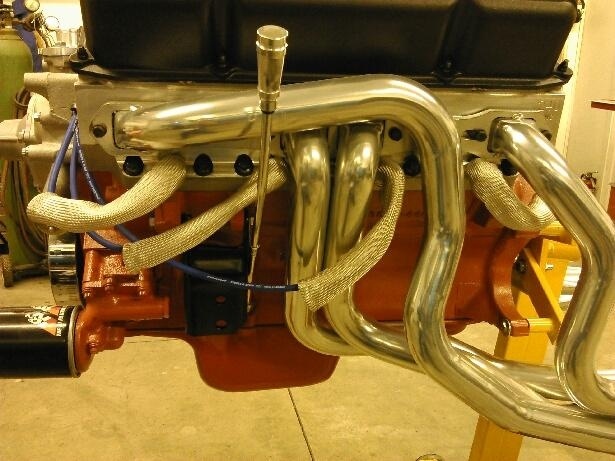

I have had TTI 2" on my '66 Satellite 440 with EDE Performer RPM angle plugs that fit fine. Probably better than a straight plug would.
