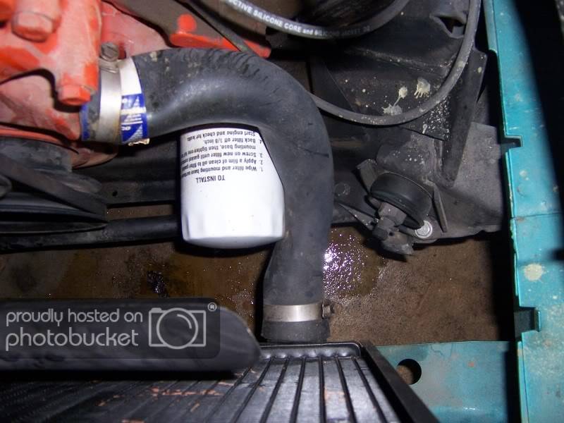

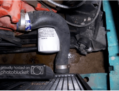

Hello from Tennessee . New to this so here goes, my problem is I'm running a after market radiator and my lower hose is hitting the oil filter. Anyone have a fix for this? This picture is not my car but is my problem.
I believe there is a better fitting hose to be had. many times I have hand formed a pc. of heavy wire and took it to the auto parts store and usually have good luck but you may have to make it out of 2 pcs. If that is for a BB mopar I would be surprised.
:welcome: aboard. It doesn't mean that you can't join unless you have a problem. Obviously if the standard radiator didn't have this problem, the radiator needs to be replaced . Or is the mount in the wrong place ? Need more info. Is the picture of the same brand of aftermarket radiator that you have ? Contact the radiator manufacturer for their advice.

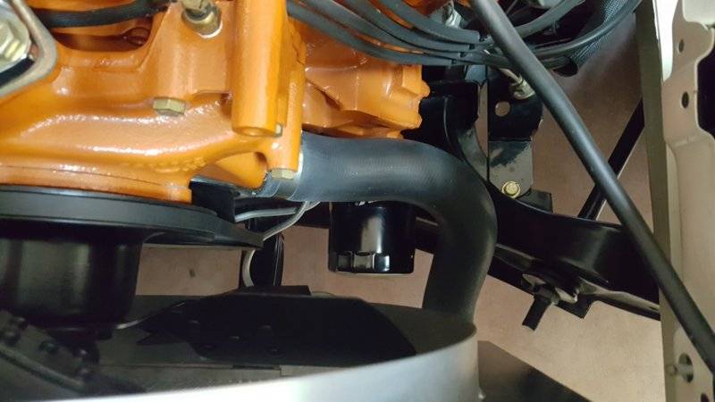

+1 for Fran, my thought exactly. Kinda looks like a SB to me also. Mine only comes close at forward edge of filter. 440 in a Bee, but not touching anywhere.
It does look to be an inch or so longer up by your hand.
