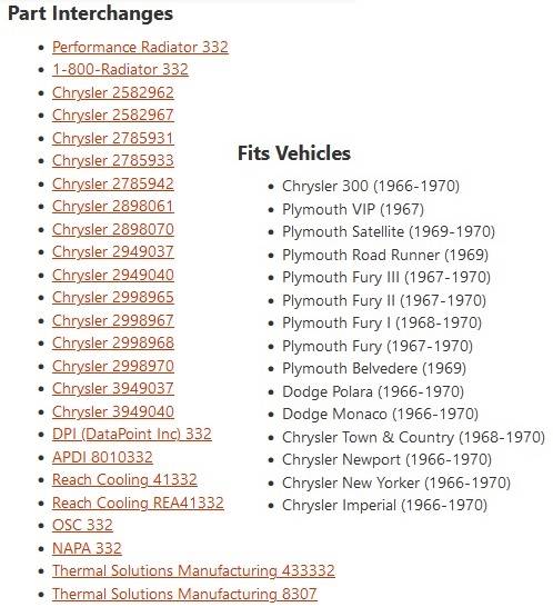

Spectra radiator cu332 fits a satellite big block engine 440 on there website. ...yet they don't cross over at rock auto or at spectra to a GTX. Nothing crosses over except the aluminum rad at rock auto to a GTX when you look on their website. Anyone know if the cu332 fits.? It's a 3 row. 26 inch radiator. Spectra
I don't know personally, but I lifted this info from a website. FWIW
FYI, I think that the same unit I got for my 67 Cornet wagon with a 440, but different manufacture. Got a reproduction shroud for 67-9. However as I have since learned, since that unit also fits c-bodies, it actually takes the c-body fan shroud which is different than the b-body. Uses the 66-70 c unit which I still need to get.
