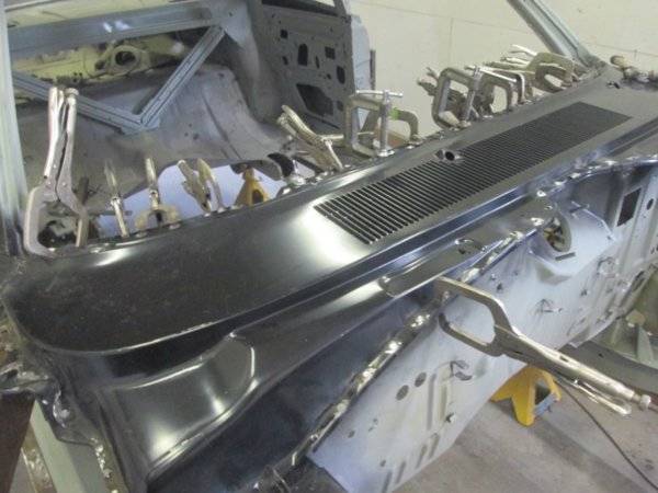

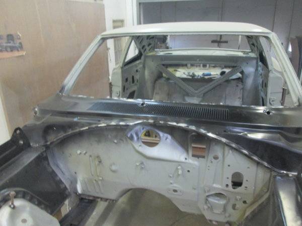

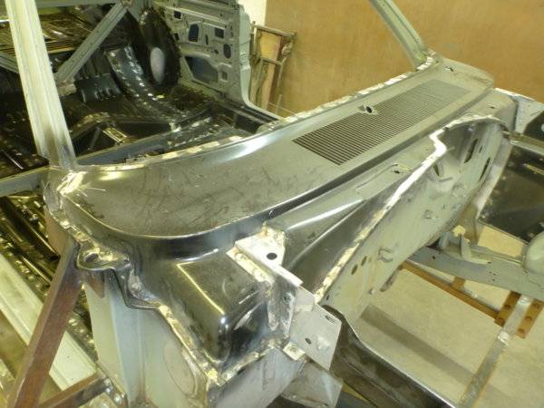

Odd.. my upper cowl fit perfectly !
I`ll take that panel alignment/ easy fix over a lot of the China made junk I used to deal with in body shops and a lot better than having to fabricate from scratch or trying to find high priced used panels and have them shipped across country. Also remember these cars had tolerances of +/- 1/8 to 1/4" from the factory, I bet even line workers used hammers a lot.
It's this "Junkerup" from YouTube??AMD has a new supplier and their fitment is crap, tried to install wheel houses from the new supplier and not even fuckin close!!! I had one of their old wheel houses still and it fit great. Had to slice and dice the outer wheel house and then had to extend the trunk extensions. Plus none of it has the sharp edges the factory metal has. Prices go up and quality went down
