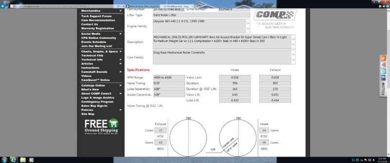

these new 1.6 ratio RAS rockers r going to change my lift and duration .. how will that change my final numbers..both lift and duration,,and at .050..blurry pic..lift is .650,,.651,,,,.296--.303,,,@ .050.263--.270,,,108 center..based upon 1.05 stock rockers..
To see what effect of the 1.6 rockers will have on the "valve lift" multiply the lobe lift by 1.6. Duration remains the same because it's "tappet lift" @.050. Net valve lift is tappet lift x rocker ratio minus lash.
