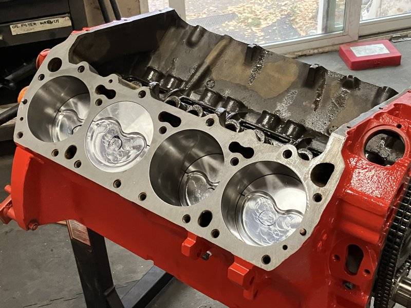

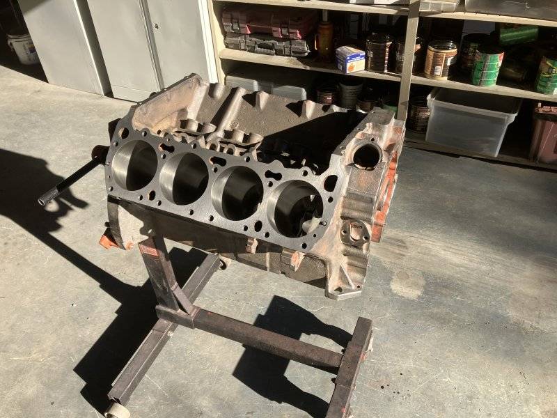

Pulling my '68 440 and wanting to clean it up and paint the engine with as close to the original turquoise as possible. What have people found for the best manufacturer of turquoise color paint? I am seeing threads regarding spray on (rattle can) versus brush on paints. What have people found works best and any tips or tricks would be appreciated.

Please enlighten me. You're going to pull, disassemble, clean, prep, paint, reassemble, reinstall THAT engine ? Looks pretty good to me. Anyway... I spray.

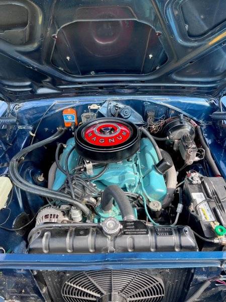

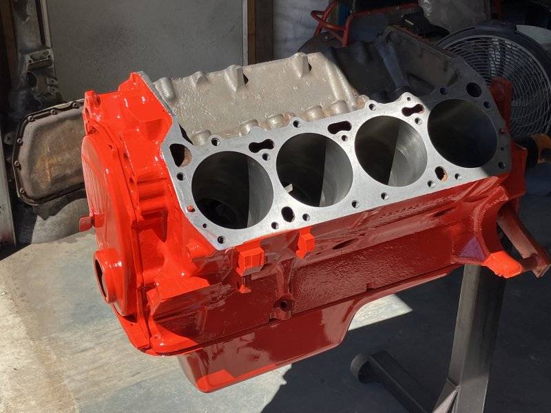

I use etching primer and rattle-cans. I've also POR-15'd an engine black, and it looks like glass. Zero issues with it, so far.
VHT
Sprayed 5 years ago. Same with headers

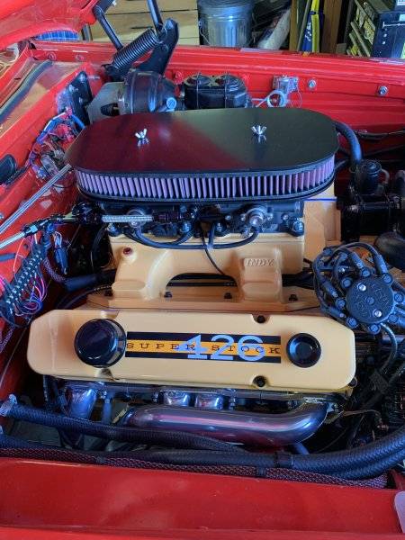

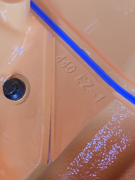

Restoration Shop Products:
1) KW901 Grease & Wax remover
2) Brushed on epoxy primer
3) Brushed on Single Stage Acrylic Urethane & Hardener
This was done with the engine in the car. The pan and valve covers were sprayed, as they were separate at the time.

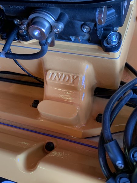

Thanks, Doug (DKW) for the suggestion. Worked great, spilled gas doesn't bother it and it flows so well I defy you to find a brush mark anywhere...

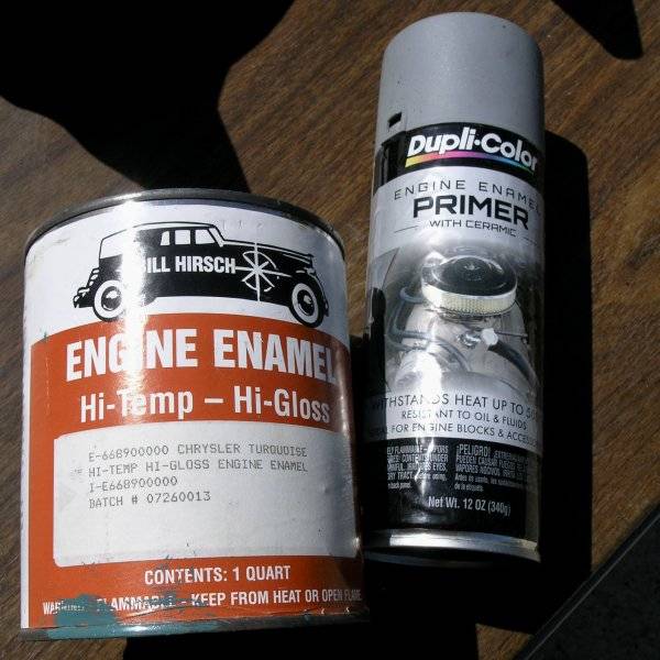

I have Bill Herschel on mine,bought a quart,primer on clean block,sprayed it with a gun. Don’t buy a quart unless your painting several!
