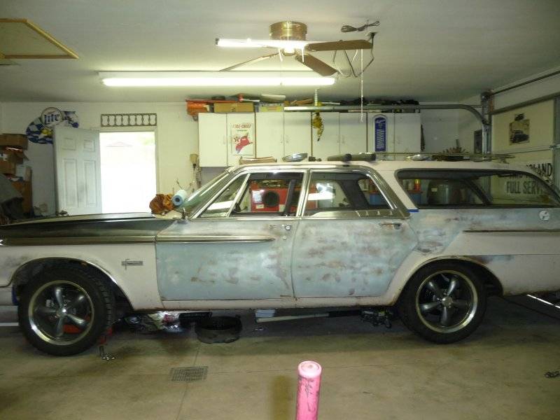

No black , I going to use a 1962 Plymouth factory color (and it's not going to be white either)...yeah that 6 pac (4brl) type air cleaner looks good on that 318 poly...from a distance it looks like I have a 440 6 pac under the hood.
Unless you do it in one shot, paint the engine compartment, drop the engine in to make the car mobile. Outside panels can be done at a later date. Unless you would like to pull the motor again.

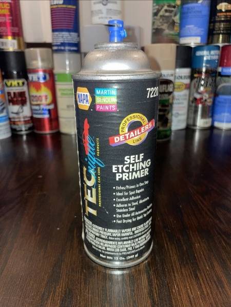

napa sells a pretty good aerosol etch primer
