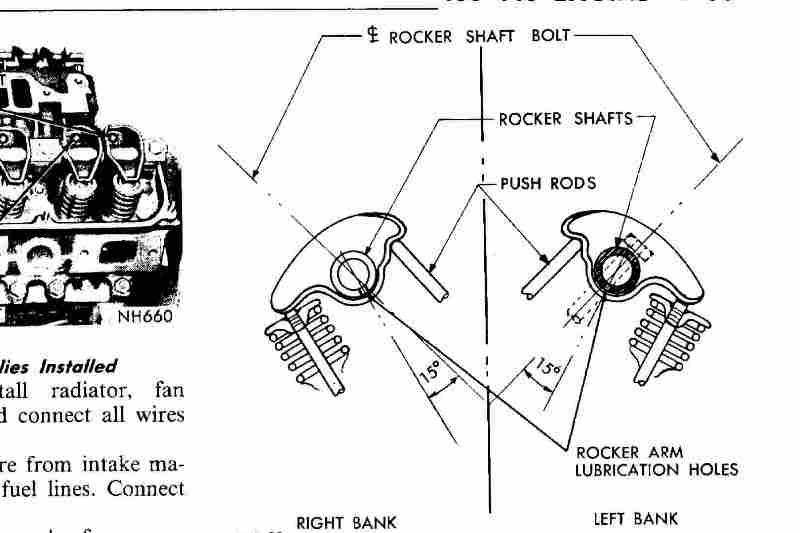

Please check to make sure your rocker shaft isnt turn over. There are oiling holes on one side but not the other. If you have the shaft turned wrong it wont get oil on that side.

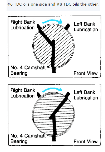

It has been my experience with the big block Chryslers that the right bank (2,4,6,8) will prime when #6 cylinder is on TDC and the left bank (1,3,5,7) will prime when #8 is at TDC.
Yep. As above, the v8 is 90° bank to bank, so the oil holes are 90° apart.
Which ever bank you get oil on, turn 90° from there. If that doesn't work, go 180 more.
Oil holes in the rocker shafts point down and towards the valves.
