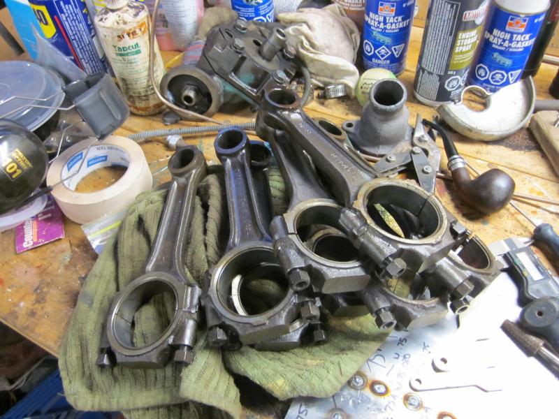

Should original rods be automatically discarded when doing a rebuild?
I acknowledge new rods aren't terribly expensive but it seems a waste to just throw away a set of LY rods that seem ok from an engine that shows little wear.
The argument from the shop is that by the time they are checked, cleaned, and resized, the cost is likely a wash.
Wondering why the rods would need resizing, is this always done or a result of an inspection. What exactly is being resized? Are both journals likely to change shape over time? If they checked out ok and are not twisted, do they still need some machining?
Does any work need to be done on a new set or are they so precise and evenly balanced, the pistons could just be installed and assembled onto the crank?

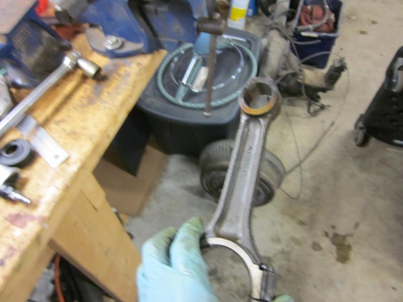

I'd like to be able to check them anyway for piece of mind. What's the best way (without a press) to pop the pins out? I was thinking of heating up the rod ends and pressing them out with a large c-clamp I have if I can find the right size sleeves.
Don't recommend heating the rod ends, not with the pins in place. Both rod end and pin itself will expand, so no help there.
If you have a service manual, it shows the factory tool used to both remove and install the pin. Might give you some ideas what is needed. That tool is something I should have found, or made, many moons ago!
Just need to pull/push pins out as they sit, for best results. Another little note is, when the pins are installed, they need to be centered on the rod end, meaning each end of the pin.

Forget the C-clamp bit. It won't cut it.
Worth paying someone to press 'em out, and be done with it. Easier on the rods, too.

As far as the C clamp goes, I think it will work with proper sleeving. This clamp is quite large, used for ball joint removal. I'll do some experiments this weekend and see what comes of it.

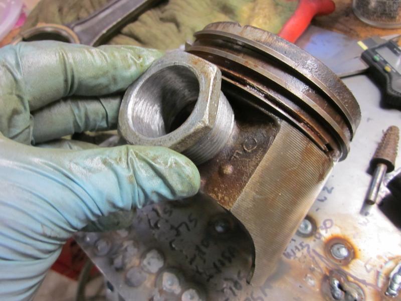

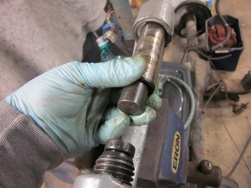

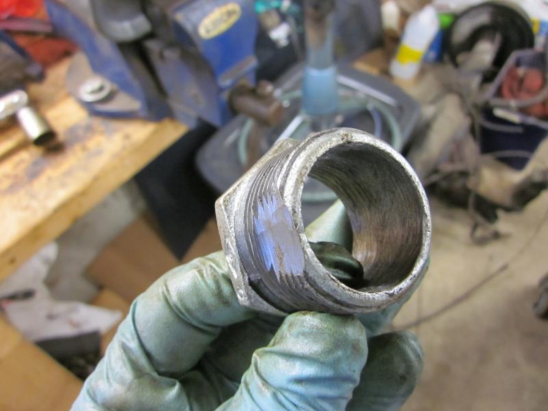

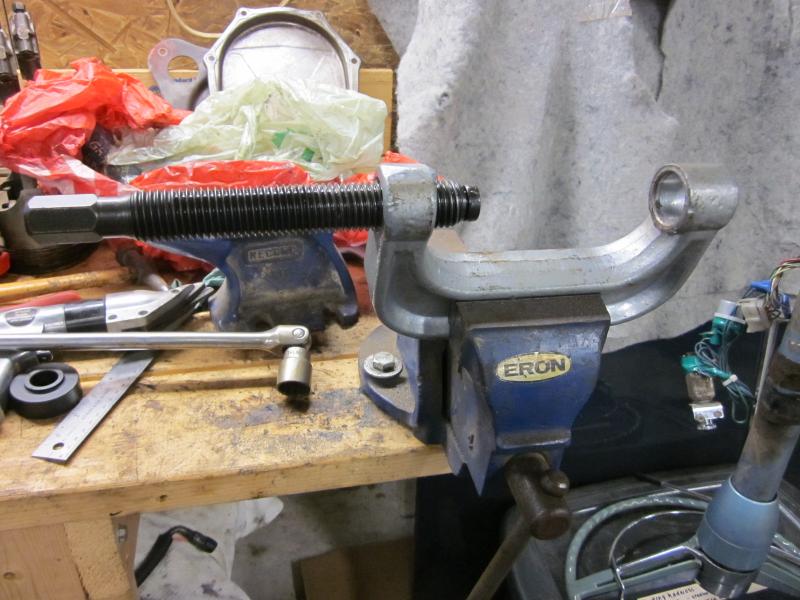

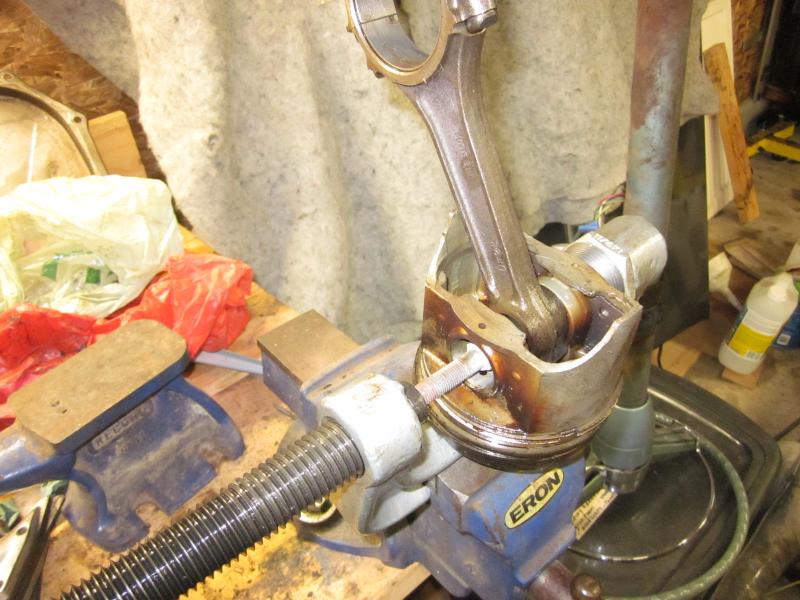

The C clamp worked very well. Here's my set up...
I had to find a way to put a sleeve against the pin bore. I used a rigid reducer which I flattened one side to fit between the pin bore and the piston top. Then I milled out the sharp threads inside to smooth it all out.
Wella, all 8 done which took 5 minutes each.

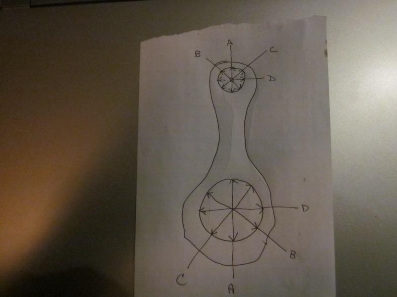

I did some checks and here's my numbers. I'm not sure how good or bad they are though. Thoughts?
