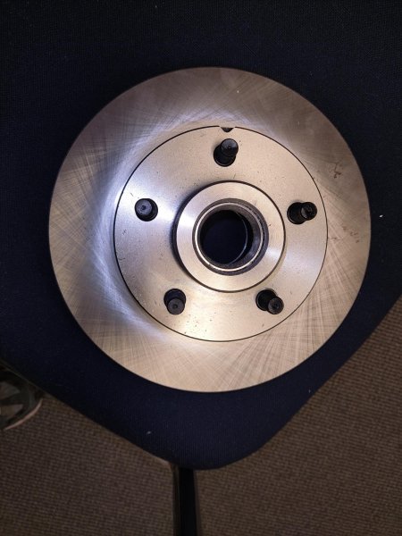

I'm sure this has been asked before, but my searches in this section for "rotor notch" or "divot" or just "notch" turned up nothing relevant. What are these notches for? Online searching seems to show a different kind of notch is machined along edges of rotors to balance them, but both my old and new rotors have these notches cut in right in line with a stud, so this doesn't appear to be a balancing mark, but rather positional. What are these notches for?

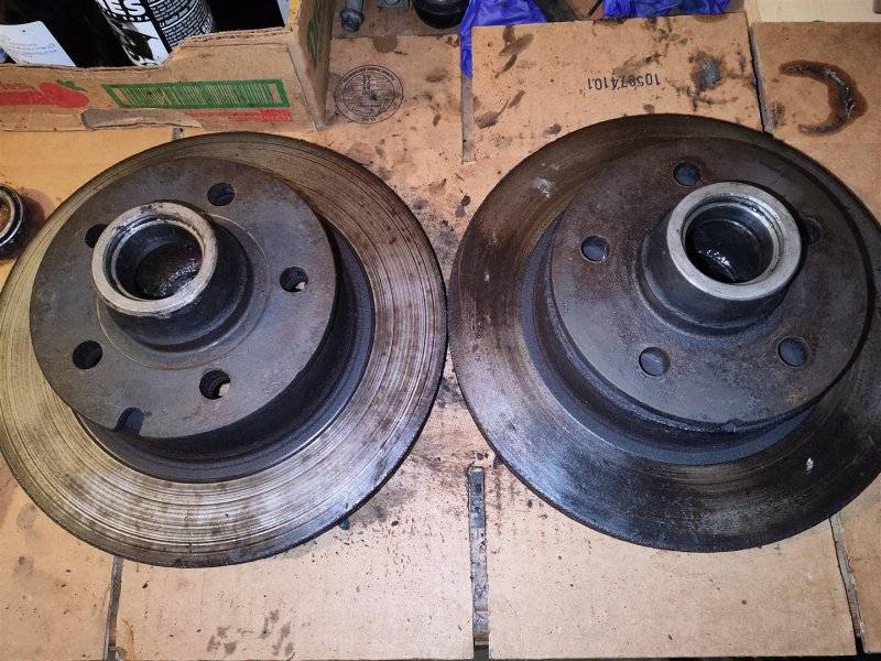

My original rotors have the same notches in them. This doesn't seem to be the same thing as the balancing machining, which isn't a divot like my image, but a small area ground away. Side-by-side, the new looks identical to the old. I'm guessing it's indeed for balancing. Rotors are an extremely heavy part, relatively speaking, and directly involved with steering and suspension, so if they weren't balanced, you would DEFINITELY notice it. That's why they balance wheels, and a bunch of mud and dirt accumulation inside a wheel can cause vibrations.
EDIT: I believe we now have a definitive answer on why rotors have these notches. I never had a look at both of my old rotors until tonight. The notches are shown on the bottom in this pic, and are different sizes. Clearly this indicates the reason must be for balancing...and that one of them was not machined very precisely, from the looks of the amount of material machined out. :rolleyes:

Which is exactly what I've shown in my image showing my two original rotors. The notches are different sizes.
Please note the location.
All notches shown are either
in line or exactly centered
between two lug holes. If
these notches were for
ballancing, they would be
in different locations around
the circumfrance of the
rim mounting surface.
