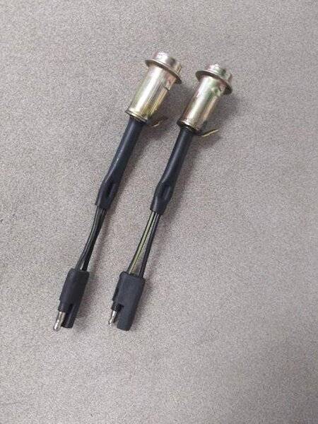

Sounds like the only downside is that his leads are for an E body and they are a little shorter. Also he said the terminals are not Packard 56 but the plug is correct. I have the Packard terminals and can change that out. The shorter lead will work fine as mine were long anyway. But those are the differences he stated. He texted a picture of them. I may be able to post it but going to be tied up for a couple of days.
This is the pigtail leads Mike at AEB Mopars said he has for the parking lights.
completely different type of plug on the end.
BUT, not terribly difficult to change
I would remove the entire wiring pigtail out of my old lamp assy and transfer to the newly installed sockets
Your right - I forgot the plug is different as well as the terminals. I bought a bunch of male/female plug pieces and packard 56 terminals so changing is not a problem. He also said the wire colors may vary too and might result in reverse wiring them by accident - but if that pops up just reverse them in the plug.
