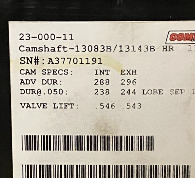

This week a buddy brought over a 1990 360 that he didn't want or need. It is a factory roller cam version before they went to the "Magnum" 5.9 design. It got me thinking more about the swap to a roller cam in the 440-495.
One thing I'm going back and forth with is the lifters....solid or hydraulic?
One of the things that make a hydraulic tempting is that with no valve lash, it would run much quieter.
Yeah, I know....these are hot rods and they make noise. I don't mind most of it, in fact I love exhaust rumble and a bit of cam lope. It is the clickity-clack of valve lash that sometimes annoys me. I've heard that even the hydraulic roller setups have clatter. If that is due to the lifters, wouldn't a solid roller also have clatter but be simpler and cheaper?
