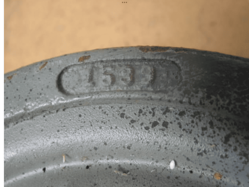

Was wondering what style rear brake drums, finned or smooth style drums on a 8 3/4 rear end, Hemi, automatic. thanks
that's what I have thanks. Also had reddish orange paint under the the cast they repainted the drums with.
The paint was Chrysler industrial red, it was used on cars that you could see the drums from the exterior of the car, i.e. had Rallye or Road wheels, The pain was not applied when full standard steel wheels were used.
The paint was haphazardly applied, and drips were sometimes found on the barrel of the wheel.
My 440-6bbl still had the original date coded 10” smooth drums - not finned.
