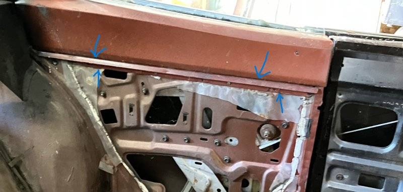

Was trying to install my rear door panels on my 70 charger and there is a metal upper part that goes over it or under the panel thought someone on here might know
There is a thin channel that the top of the panel fits into,
.....then 2 or three push-pins to secure the panel to the body.
