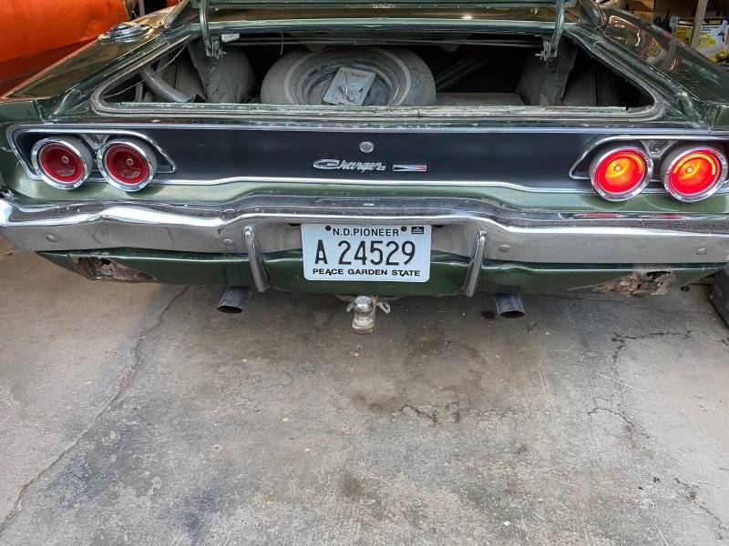

rear driver side brake lights stop working.

Any suggestions on where to start to fine the problem?
thanks
I would start checking ground wires etc
Does the turn signal work correctly on that side? If so for sure the turn signal switch.
Well now when I move the charger the left brake lights started working again. What the heck...
