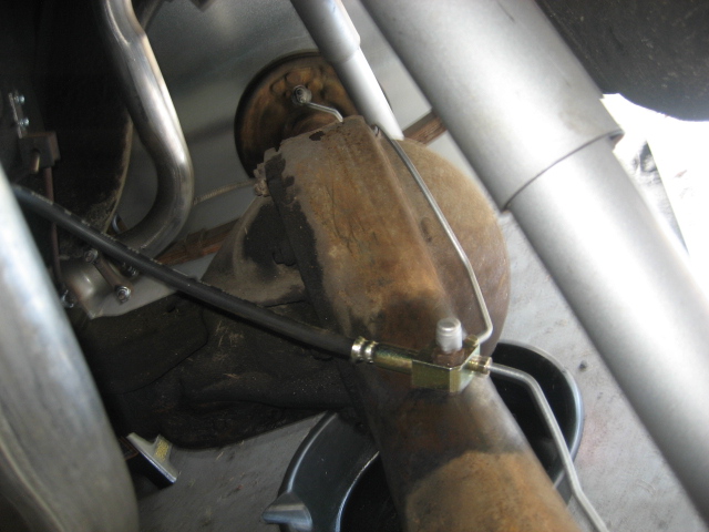

If your rear flex line looks like this. Your block is attached to the line. That vent cap pops off
