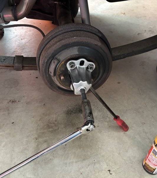

I’ve been trying to remove the rear drums on my 62 Dart. The shoes are adjusted in and I have pulled on the breaker bar until the axle lifts up and bends the pry bar but it doesn’t budge. I had the center soaking in PB Blaster last night and still nothing. Is there a trick to getting them off? Do I need to pull on the drum and not the wheel studs?

If it's a original '62 with a "Tapered axle" you need a special tool.. the drum doesn't come off the studs they are "Swedged" in.. you take the nut off the end of the axle and the hub/drum come off together... you can modify them to take normal drums after you get it apart.. i wish you were local i would give you the tool and my old hubs...
The tool isn't too expensive.. you set it up like this and use a hammer on the ends of the handle.. the hub comes off easy enough usually with the tool.
There is also no real reason to not re-use the hub/axle setup.. they are very strong.
Also.. here is a thread about how to convert the hubs to use normal b-body drums.. nothing hard other than getting the proper studs.. basically drill out the old studs, remove drum.. hammer in new studs and done
The puller I have is very similar to yours. It just uses a socket instead. I’ve also beat the end to try and jar it loose. No dice. Since it’s a whole hub unit, I’m not sure if using heat would work?
heat might work... but honestly... i would airgun the tool and keep hammering/tightening and at some point it will pop....

No worries. I knew they were tapered. I’ve just never had one this stuck on before.
also, besides hitting the one part, a light rap on the threaded one when under pressure can help it pop

Chance that the shoes are seized to the drum? If the drums are grooved it would make it more difficult. Are you planning to reuse the drums?

Seized, no. I drive the car quite often. Grooved, possibly. I had the adjuster in quite a bit but was afraid to go too far with it for fear of it falling off. Then I’d be really screwed. I was planning on reusing them. At this point I’m wondering if going with a newer rear end would be better long term.

If the drums are stuck fast to the taper spindle, time to get the correct tool. If they are stuck to the shoes, grind the head off of the shoe retainer pin from the backing plate to get them out.

You don't need to change the whole rear, you can just swap the axles if you feel you need to.. but once you get that off you should never have a problem again.
