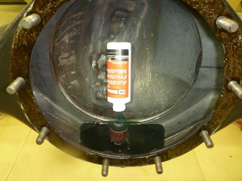

Dinosaur 80W90 gear oil + the stinky stuff.

Cass aka Dr.Diff recommends SuperTech gear oil from Wally World along with a bottle of Ford friction modifier. That has always worked for me.
