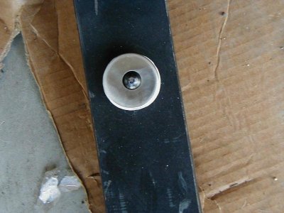

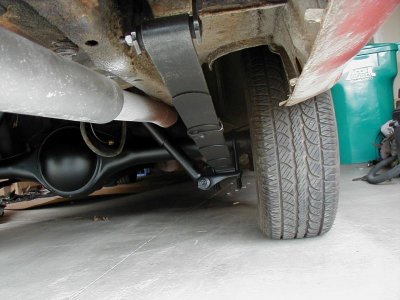

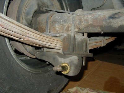

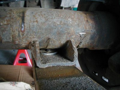

When I bought my 63 I found that it had a 73 rear end under it with the isolators and the large spring plates. All of the geometry was thrown off and I almost had to use a hammer to get the rear shocks off due to the angle that the over sized spring plates had forced them to sit at. I ended up purchasing a set of original early style spring plates and eliminating the isolators all together. The main probem you will find is that there is a much larger hole in the spring perch that is welded to the rear end housing...I think its about 1 1'/4" in diameter compared to the 1/2" that your car came with.
I purchased new SS springs which had the 1/2" pins and ended up making two stainless steel reducers 1 1/4" x 5/8" thick with a 1/2" hole in the center. Once installed they are a captive fit between the rear end housing and spring plates and fit on the 1/2" sping pins perfect. Another thing I found out was that the 73 rear end housing is almost 4" wider than the housing that would have been in the car so if buying wheels I will need to allow for more back spacing....unless I change out the housing for a 66 or 67 housing.
