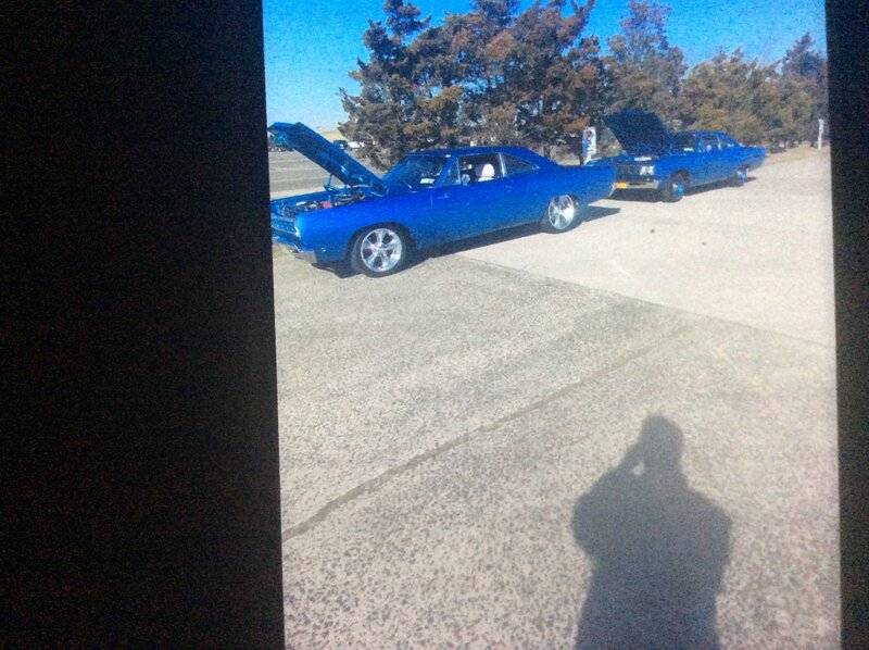

Here is my friends car .He change his entire suspension to lower his car plus he put 20” rear tires in rear
