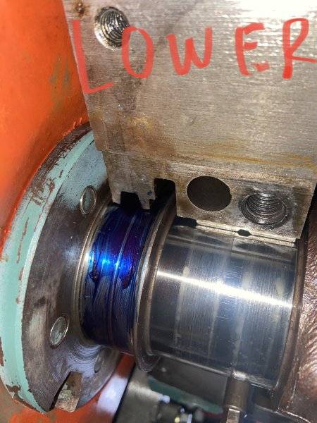

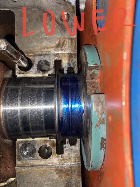

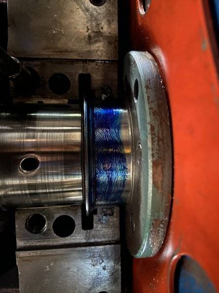

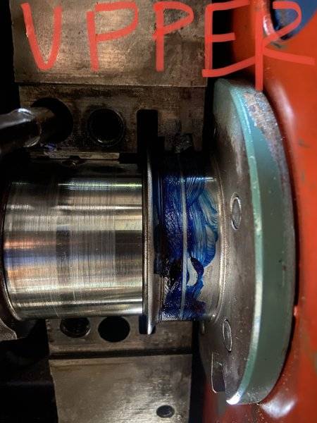

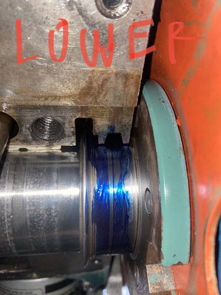

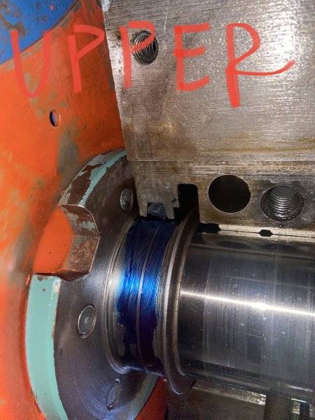

I found this video that gave me a way of checking the contact of the seals on the crank.
After doing this to my engine, the upper seal seems to make good contact. Leaving a constant clean line where it wipes away the Prussian blue. The lower seal on the other hand leves an inconsistent line and seems like still leaves a film of Prussian blue behind.
That is the feeler gauge size I started with and did not fit. Kept stepping down until .008 fit a little tight.
Well, after replacing the rms a third time and it still leaking I am throwing in the towel for now. Does not leak that bad so I put it all together yesterday and took it to a show today.
