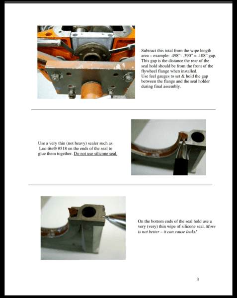

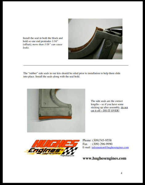

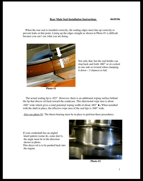

This is what I got directly from Hughes. It comes with the new aluminum seal retainer. Follow directions exactly. I had mine put in by certified mechanic and told him to follow directions, but he took a shortcut on the side seals ( filled the groove with silicone) He had to do it over again , on his dime, and buy me a new pan gasket. No seal leak now................................MOI used the Viton seals and followed the instructions to the letter. Centering the cap, useing #518 Loctite to glue the two halfs ect. Dry as a bone so far. They are good for a car that might sit for long periods. These are the PDF instructions you get with the set from 440 Source
http://www.hughesengines.com/Upload...in_Seal_Installation_InstructionsJune2006.pdf
View attachment 545441 View attachment 545442 View attachment 545443 View attachment 545444
