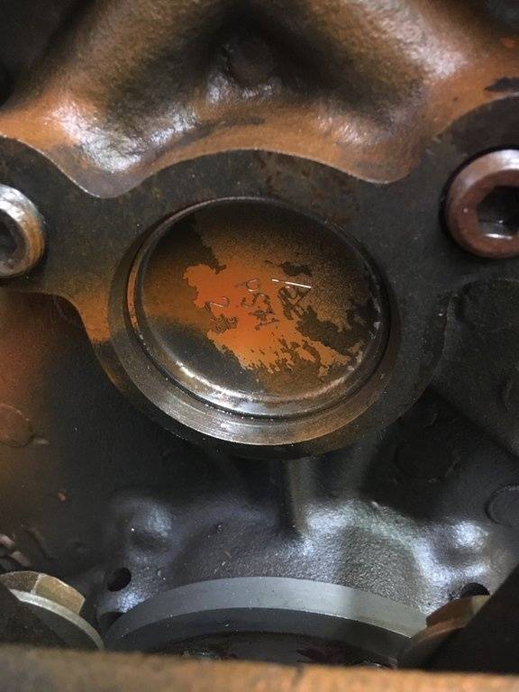

70 440 4spd car. I've got oil gushing out of the bellhousing (qt/30 miles). Definitely oil, not trans gear lube. Top of bellhousing is dry. Oil sender and back of both valve covers dry too.
Well, I replaced the rear main seal/side seals (old ones didn't look bad) and it's still gushing oil from the bellhousing. Where else could a 440 be leaking oil back there and how do I diagnose and fix it??? Thanks for help in advance!
Rear cam plug. Isn't there also 2 oil gally plugs back there?
There's only oil pan and gasket, rear main, side gaskets on seal an 2 plugs in back of block. Unless somebody didn't tighten plugs or left them pretty loose. I had a plug leak, my fault, because I didn't really tighten it. To remove the one that was in there the machine shop drove a torx socket/bit in it to remove it. I was a little gun shy on tightening it. * hours to pull engine an put it back in, I test engies for leaks before putting them in.
All good tips.1.Did check oil sender and it is dry. 2. How much oil could leak from excessive crank endplay? This is A LOT of oil. 1 qt/30 miles is no exageration at all. 3. I guess the rear cam seal (looks like a freeze plug, right? OR oil galley plug(s) are my only options left, correct? Please jump in here.

Yes - only four sources of oil in the bellhousing: (2) lifter galley pipe plugs (full pressure oil 100% when engine's running); cam plug (splash fed oil from the rear cam bearing); and the rear main (splash fed from sump). My money is on the pipe plugs if it's really that fast.

Well, the motor is in the car... lifter oil galley plug is the winner (or loser I guess). I vaguely recall putting some teflon tape on those when I had the motor out... hex bolts, right? And sort of near the back cam plug, looks like a freeze plug right?
Yes... it IS gushing that much oil. Maybe one I didn't tighten too well vibrated & backed out... dang it... but at least I'm on the right track.

I had to remove the motor for what I thought was a rear main leak. it turned out the machine shop put the cam plug in crocket causing a leak.

I had a persistent leak back there that turned out to be loose oil galley plugs! I pulled them out, cleaned them up and screwed them back in with Gaskacinch. No more leaks!

All really good input. My 2 cents drop the trans, pull the flywheel, get a good look. Either cam plug or (more likely in my op the galley plugs).

I haven't pulled the transmission/clutch/flywheel yet, but based upon the pure volume of oil & the help from members on this site, I'm pretty darn sure it's an oil gallery plug. I "think" I got some with a freeze plug kit & put them in "just because"...pretty sure that was a bad move.
