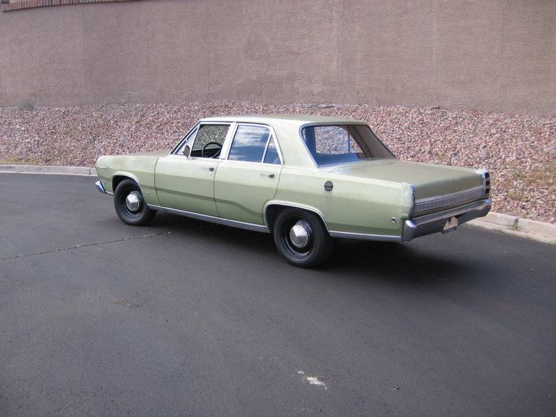

See the difference between the top photo to the bottom. About a 2'' lift. I added 2 leafs.Cost was my time,4 new U bolts and 2 center bolts bought at the local auto part store.
I have done the same. Take used leaf sections of the proper length and mix and match. It is time consuming but very low cost.
You two nailed my next response.
nice, love the height. I will check around, a friend of mine may even have some.
