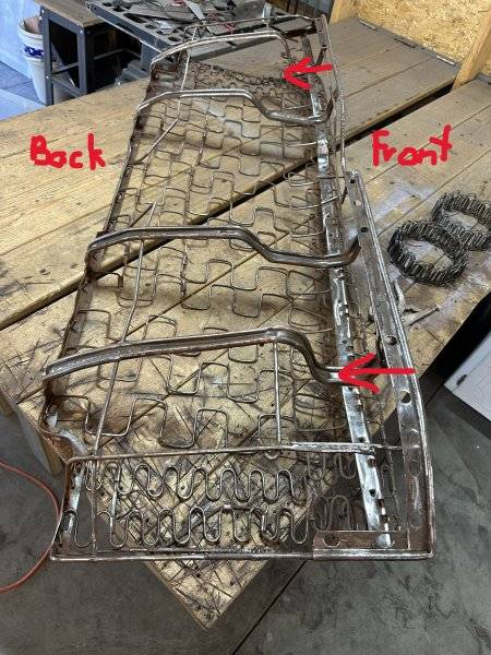

Here's the seat from my 68 Coronet. it's upside down but will give you an idea of the frame that your bending to unlatch. As someone else said, you're unlatching the bottom so pushing on the top of the seat will do little if the seat's jammed in there tight.
