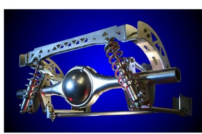

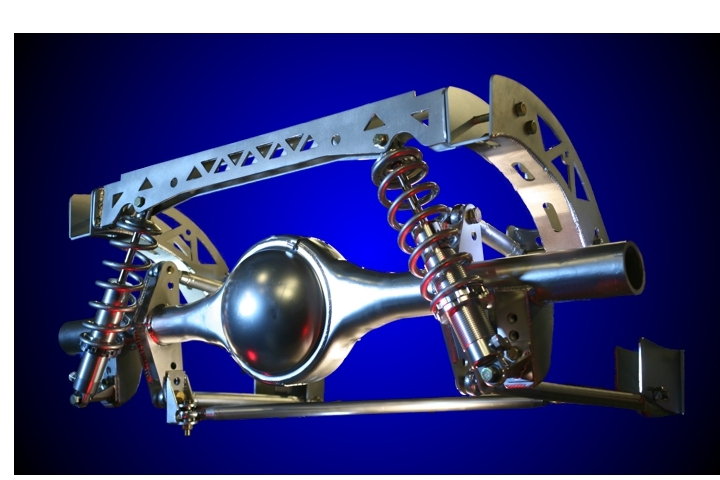

This is a new product from a mopar only shop... magnumforce
