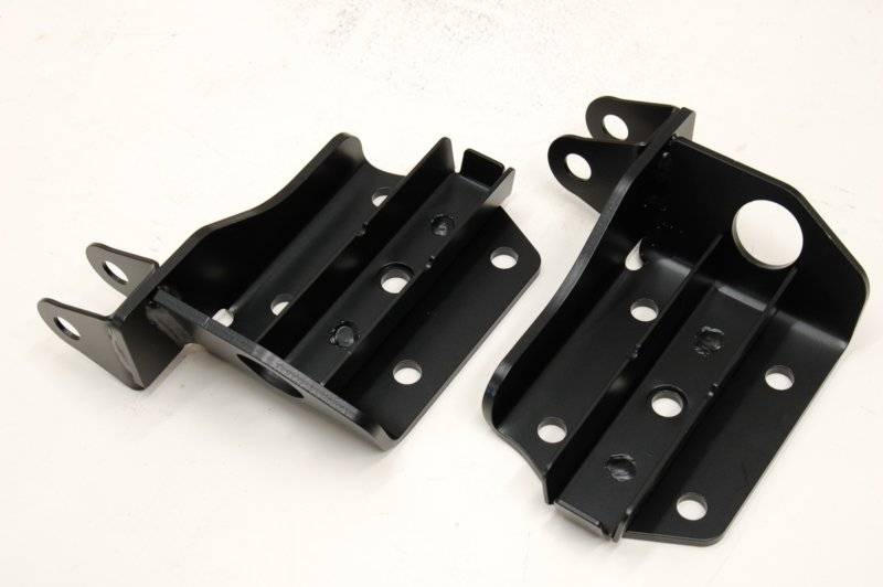

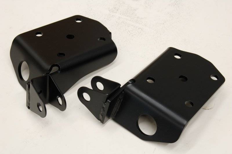

I found out the hard way that Koni shocks use a 5/8 mounting stud rather than the correct Mopar size. Evidently the Koni engineers aren't capable of reading blueprints and I guess they refuse to correct their error. Anyway, rather than trying to get them to correct their mistake I just decided to build some custom rear shock plates that would use a 5/8 mounting bolt. While I was at it I turned the shock mount 90 degrees so I could use a double shear bracket. I also added a tie down loop to the shock plate and then welded a cup for the jack stand in the bottom of the mount. Here is what the plates look like after powder coating. I'll get them installed sometime this winter.

Forgive my ignorance but how do you get metal that thick to bend? Anytime I have made brackets I either have to use prebent square pipe then I have to cut and weld. Do you have a super stout metal brake?

I have a small DiAcro press brake in my shop. I can bend 1/4 inch steel plate as long as it isn't very wide. These shock plates are only a few inches wide so it isn't a problem but I can't make really big parts.
