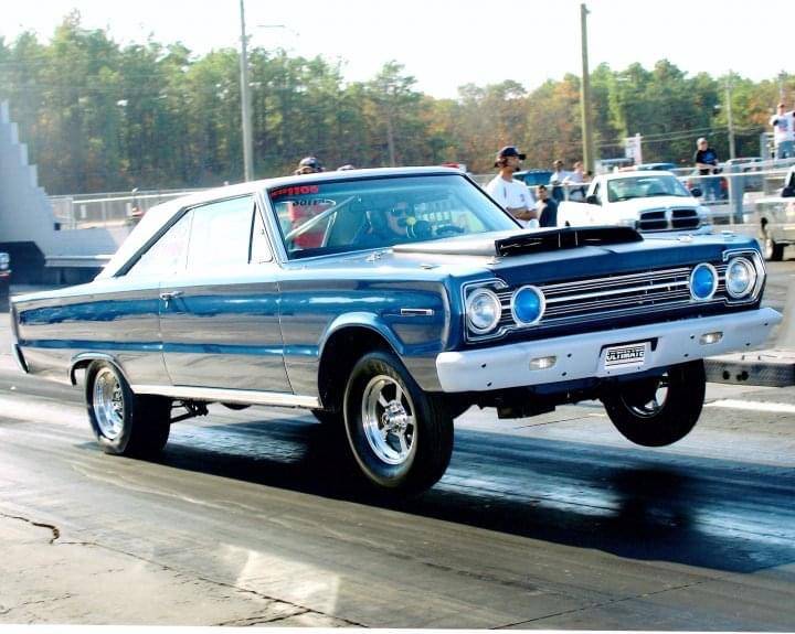

On my '66 Coronet I had 30x9 radial Hoosiers with a 8in wheel,4.5 backspace. Still had to trim the outer wheel housing lip and beat in the outer wheel house. 5 inch BS wheel would be better. I also had to space the front hangar back 1/4 inch.
This is correct -
But I raced the car in the above post for 11 years with 8 inch 4.5 backspace
It went 9.88@135 best. Race weight with driver was 3750
I think the 4.5 backspace worked ok

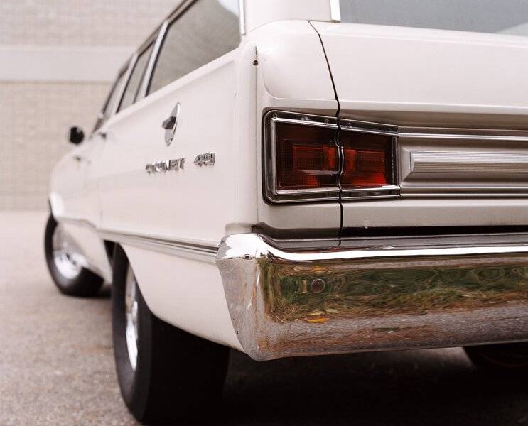

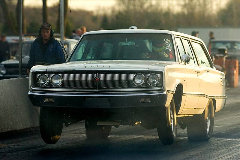

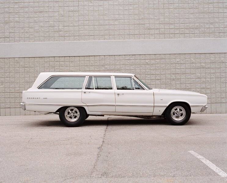

9X30- Goodyear [stiff sidewall], on 15X7 Cragar S/S. Front corner was moved an inch forward, lip was rolled, and a 2lb. hammer in a couple of places on the inside of the tub. It was very tight, but I drove it on the street.
