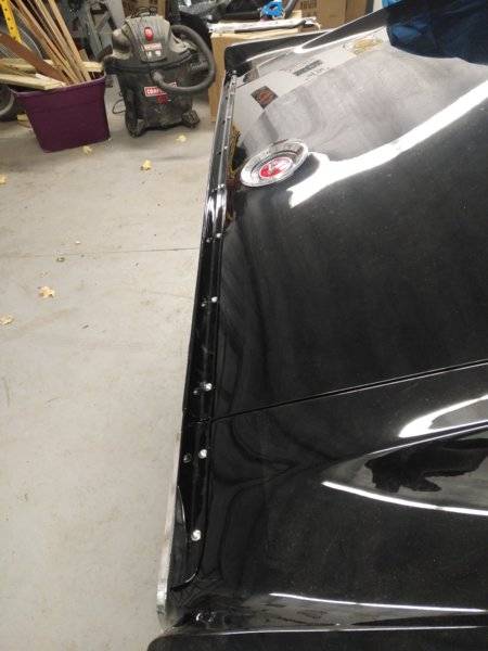

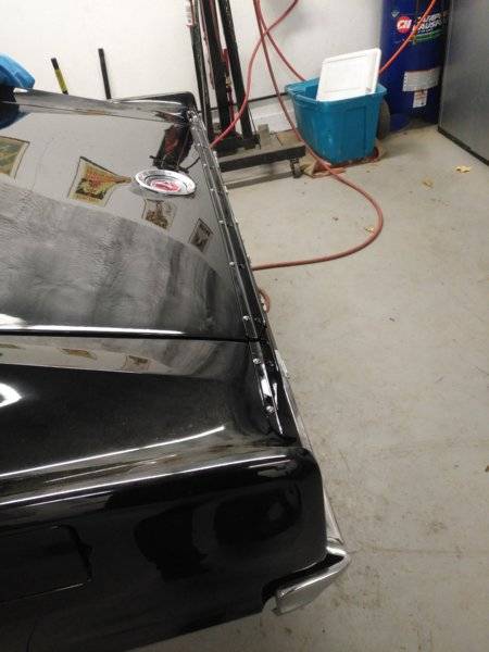

Here's a few pictures of my fiberglass spoiler from Showcases. It needed some final prep work, but nothing crazy.
It fits quite well I think.
View attachment 858010 View attachment 858011 Here's a few pictures of my fiberglass spoiler from Showcases. It needed some final prep work, but nothing crazy.

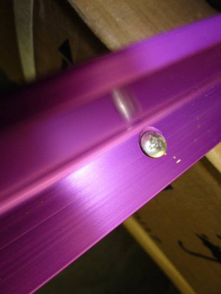

Looks pretty good, how many hours did you have to put into it? And, tried to get a better look at your fasteners, what did you use? I have still not decided to use for fasteners, do not like the like the fit of stainless phillipshead screws, picked up metric stainless button head screws, a while back, but still have not committed!!
The body shop did the prep. They didn't spend more than an hour on it. They're professionals though, so it may take an average joe longer. I used stainless button head screws as well. Yours looks great too, is it aluminum?
Those are the phillips head number 8 machine fasteners. Was looking thru my pics for a shot of the metric button head fasteners. The main reason I started looking around for some what different fasteners, was, this is an aluminum spoiler, and the predrilled holes are just shy of 1/4 inch. So 1/4 wont work, the recommended fasteners are number 8 machine screws (very loose in the hole). Having spent 4 years assembling aircraft, I just think there might be a better way. Keep in mind, the original spoiler's were screwed on, yup, screws...
Those are not a "reproduction" spoiler....it's a cheap plastic copy that is sure to break or crack as soon as you start to attach it to the car as the originals were....I hope the person that made those has taken into account of the double compound curve of the trunk lid, otherwise it's not gonna fit and will break....the 'glass spoiler has been tried before, and failed
