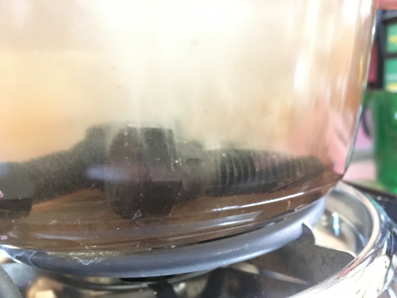

Thanks! I don’t know for sure but what I’ve seen it looks like it’s the same ‘sheen’ of black. I haven’t seen any that were bare or a color other than black. You can do phosphate one of two ways, sort of. There’s a paint out there that looks okay but it’s not phosphate obviously. Phosphate is really easy to do, if you can boil water you can do it. You can get solution from gun smith sites, I get mine from Palmetto Enterprises. You follow the directions for dilution. Get a hot plate and a non-metallic or coated vessel that will fit the part. Media blast your part, get your solution to 190* and put the part in depending on what you’re after it’ll take 5-10 minutes Pull the part and soak it in oil. Let it cool and wipe it down. Really easy.

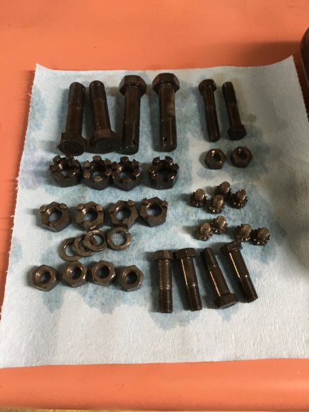

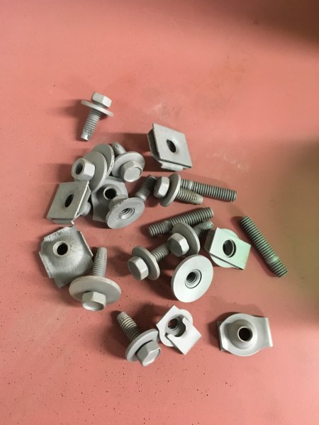

And wow, thanks for those photos on phosphate. Am I correct to say the grey bolts photo was the finished product? The finish almost looks like a lighter primer.

No, the dark oil covered bolts are finished in phosphate. The like gray is freshly bead blasted.
