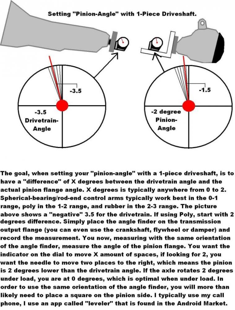

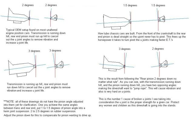

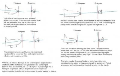

Should I install 2 degree pinion shims for a street duty car? What is the most pinion angle I can run with a street car?
Come on guys tell me something. I would like to get the thing close while I am rebuilding the rear suspension. I value your input on my build.
I use an adjustable snubber, works well on and off the track. Shims and angle, no idea, mine is stock and bites hard with slicks and snubber extended.
2 degrees will be fine for a street strip car. just check to make sure your trans. tailshaft is in the right position with the correct angle..

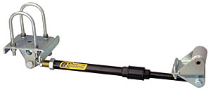

Do you have enough room to run an adj. pinion snubber ? they are quite a bit taller than the factory style, non adjustable snubbers...
I run this one.... :)

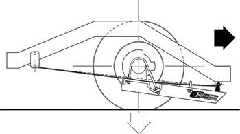

:iamwithstupid: Also Competition Engineering Slide-A-Link, I have a friend that swears by them, I've never run 1 yet, I think they should work, but are about $422 Jegs or Summit, even a good old set of slapper bars can help if your getting too much axle wrap or wheel hop...
Maybe a binding strap {or2} removed at the rear of the XHD springs will free up some movement for lift too, allot of old guys use to do it back in the day, there's a great book by Mopar Performance #P5007160 "Chassis 9th edition", has a bunch of proven old school, simple combos, it's a good read if nothing else....
  • Competion Engineering Slide-A-Link B-Body Mopar 67-71 #247-2093 Jegs $421.99.jpg
Budnicks,
Thanks for that insight. I will pull a measurement to find out how much room is available.
