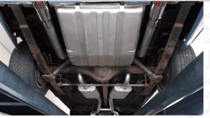

My project vehicle is a 1972 Satellite Sebring Plus (318 for the time being with 8 1/4" ring and pinion).
1) I read/heard years ago that adding a rear sway bar could be a danger if a front sway bar was not added at the same time. True/False/Maybe?
2) Would there be a problem adding a rear sway bar while retaining the original stock spring rate?
Foto represents what I have on hand (not installed yet)
Thank you.
I would add a front bar at the same time. To much rear stiffness will induce oversteer, which is a bad situation. You need a good balance between front and rear.
The factory set up production cars so that they handled in a safe manner. This meant that they tended to UNDERsteer when driven aggressively. This is a condition where the front tires lose traction before the rear. This is considered safe because the car can often be easily controlled by slowing down.
With this in mind, the factory never installed a rear sway bar on any car that did NOT already have a front sway bar installed. As stated, a car with only a rear sway bar will have a tendency to OVERsteer. This is a condition where the REAR tires lose traction before the front. In this situation, the rear of the car will slide when the car is driven aggressively and the car is much harder to control and to avoid a spinout.
