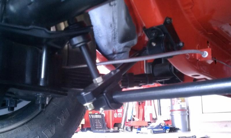

Any pictures? I was looking at taking a dodge ram link and trying to fabricate my own as well? How/what did you create?

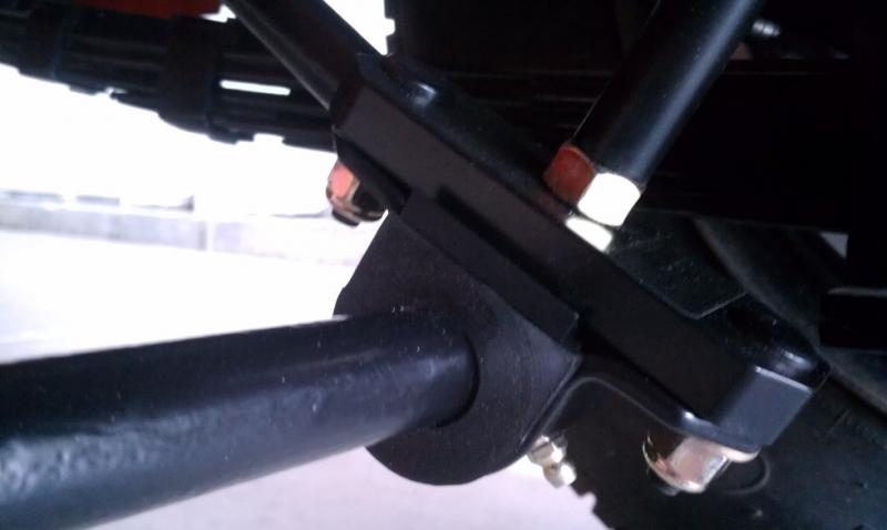

FTI, here is what the FFI end links look like. These are on my 73 RR, and yes very stout! I did have to make a shim on the bushing to get it to compress because of the way they designed them, but working pretty good so far
Thanks for the photo idrive,now I know what to do with my 79 300.
