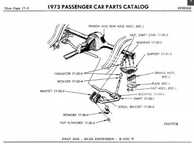

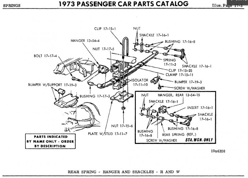

I realize the sway bar and shock mounts are two separate peices but arent the sway bar mounts sandwiched between the axle tubes and spring mounts/ISO shock mounts? And arent the sway bar mount plates located by them? (spring/tube locating peg/hole)
I'll try to dig up a picture and post it here
Well my stupid service manual only shows one or the other;
- Sway bar mounting but with the regular shock mount plate
- ISO mounting NOT showing sway bar tabs
Hopefully these will be of some use anyway

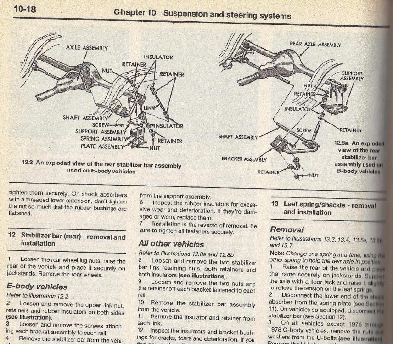

Here is a scan from my Heynes but it doesnt show that much more except the difference in sway bar mounting from Ebody and Bbody
The bar mounts are bolted on the frame and links are on the spring plate, yes you could use the bar on a older car you may have to weld a tab to the spring plate for the links.
