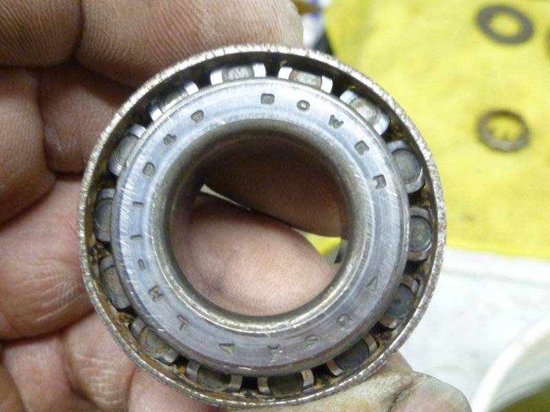

Do it once and do it right, put it back to OEM. Mine were 50+ years old on the Bee.. 150,000 + miles and still as new when I rebuilt and I'll probably kick my *** that I changed them with NOS timkens and just didn't leave them alone. I can not understand what advantage putting "green" bearings in does for anyone.

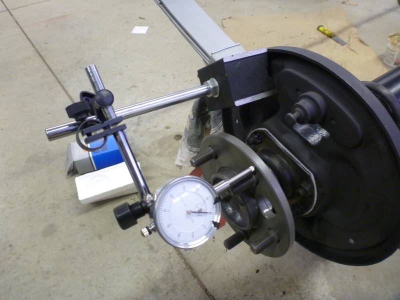

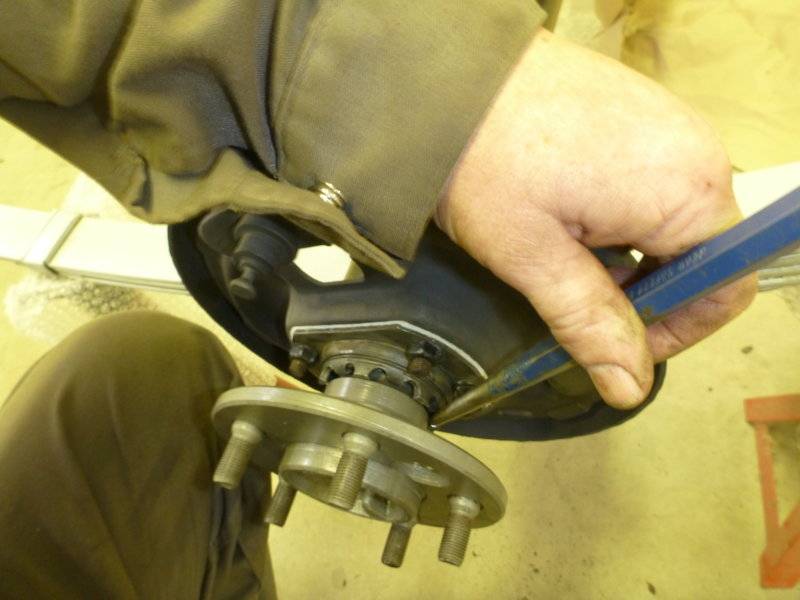

Just 10 or 15 more minutes of work going OE... just to avoid how many failures in your lifetime after that using Greens?

Timken’s are great, no doubt about it. Setting end play is fast and easy. But for how many failures are there that have not failed. Keep in mind, the all mighty 9 inch uses a Green style bearing and supposedly they go to rear for everything.
