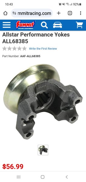

Sorry I've been busy and just now got back to working on the car. I'm still chasing the noise issue from the rear end and vibration which started all this. Let's focus on the noise first tho. After thinking about it, I hadn't really noticed the noise until I changed the rear u joint trying to fix my vibration issue. Since then I've tried three different u joints, different wheels and tires, different suregrip, had the driveline rebalanced. The driveline was out of balance but didn't change much. What I've noticed is, when I use the new U joints they're tight on the yoke side between c clips. The second suregrip is a 7260 combo, it was really tight, the noise was really loud and made noise all the time even driving straight. So I started swapping caps between all the u joints and put the thinnest clips in it. It got considerably quieter and less frequent. I dont get it. It's def not the rear gear. Just seems like it's a u joint fitment issue or something though. To describe the sound, it's an intermittent rubbing noise coming from the rear of the car when you turn. Still haven't ruled out aftermarket disk brakes or rear bearings.

Could also be a slight crack in the yoke..just a thought.
My thoughts also, as the
problem seems to be
narrowed down to the
pinion/yoke area.
